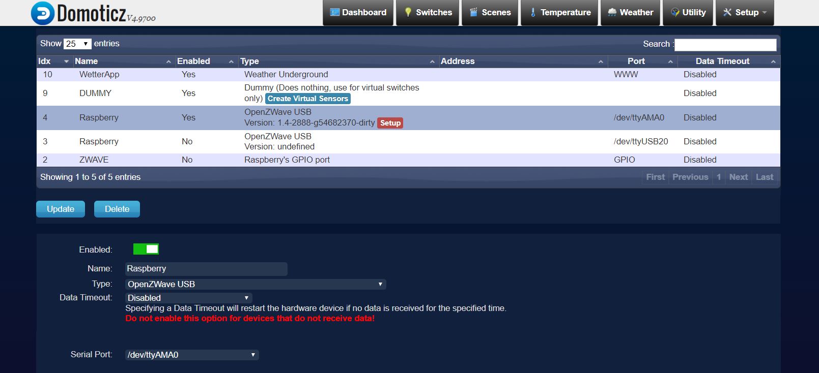

- hardware restored in domoticz
- hardware.JPG (115.72 KiB) Viewed 941 times

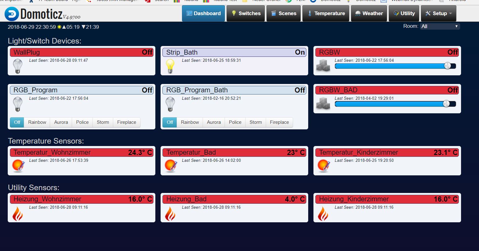

- switches restored in domoticz
- domoticz.JPG (168.36 KiB) Viewed 941 times

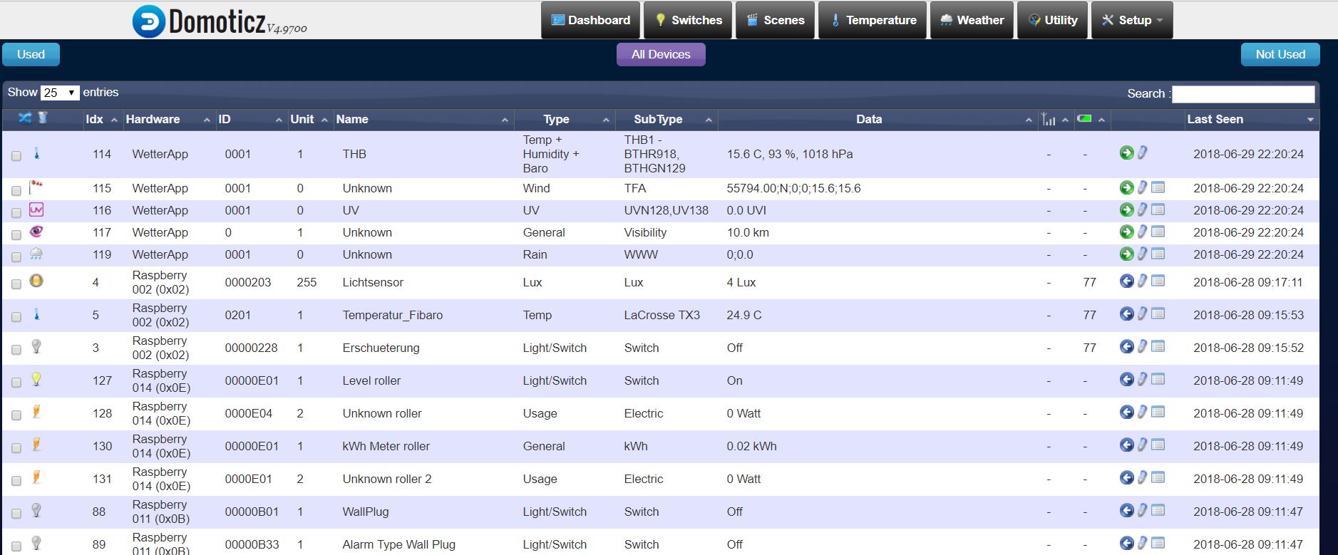

- devices restored in domoticz
- devices.JPG (200.44 KiB) Viewed 941 times

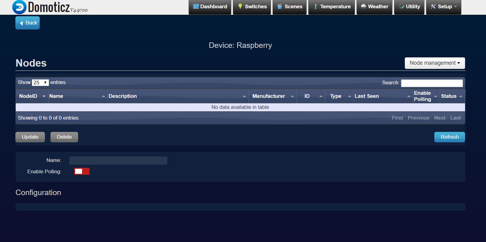

no nodes under the hardware of open zwave
- no nodes
- setup_empty.JPG (92.89 KiB) Viewed 939 times

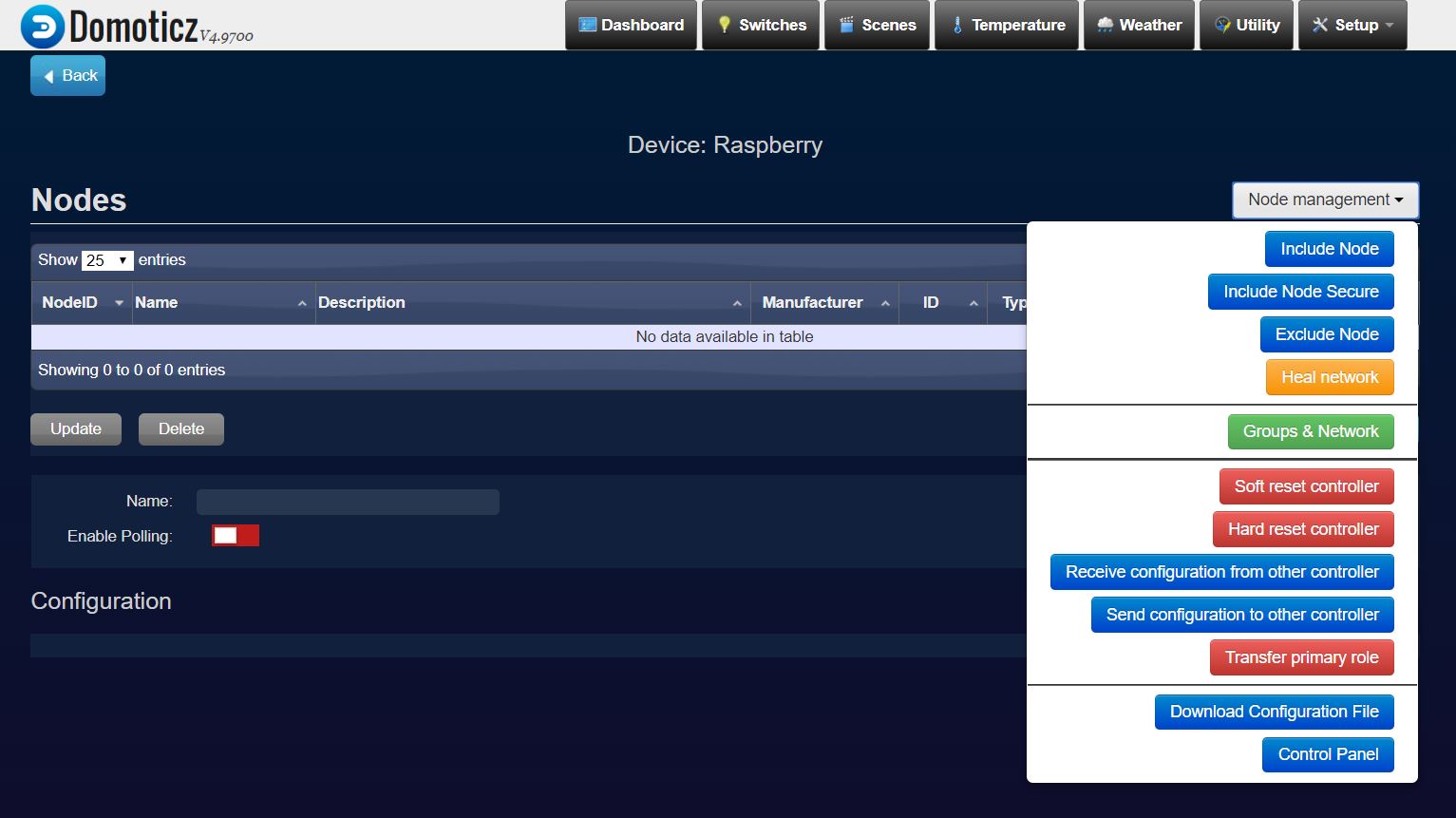

- no possibility to load configuration
- setup_empty_load.JPG (122.68 KiB) Viewed 939 times

I think your USB port is not correct, you have two times openzwave ? One with ttyAMA0 (that can not be right i think) and 1 on ttyUSB20
First, give them each a different name !! (never give something the same name!?)
- go to the devices tab, search for a switch you had, check the hardware it was used on (lets say OpenZWave_1)
- now make sure in the hardware overview, the other openzwave hardware is disabled, that is the wrong one,
- configure/enable the correct one, make sure the USB port is correct!!
- Now check the log
