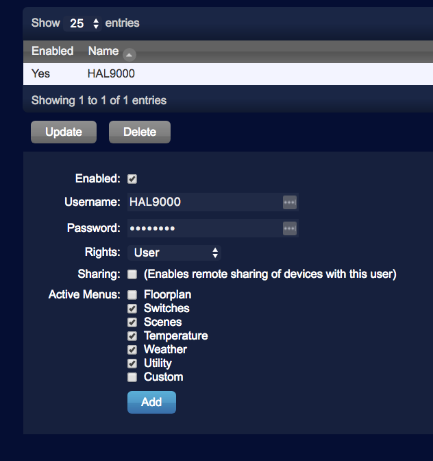

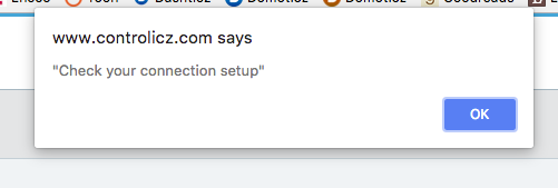

EdwinK
Posts: 1820
Location: Rhoon
Re: Controlicz - Domoticz to Google Home/Assistant integration
Post by EdwinK »
Trying to set this up. Already had contact with you. Now keep getting the 'check your connection setup' message. Tried another ddns site (no-ip), but still no luck.

EdwinK
Posts: 1820
Location: Rhoon
Post by EdwinK »
Going to try that :)
Edit: Nope, didn't work. One time I got 'check username and password' (or something close), but other then that nothing. Might be a problem with the DDNS-servers, but I can't imagine both NO-IP and Duckdns having problems. Port 443 is open.
