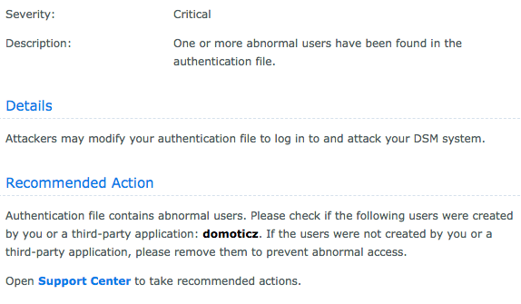

This morning, my Synology alerted me that it has been infected by Malware. It stated that a new user was created with username 'domoticz'.
If I'm not mistaken, this is the user that the package creates while installing and uses to run domoticz.
For my peace of mind, can someone please confirm this for me?
And have others received the same message?

Freekers wrote: Friday 22 June 2018 8:03 I am running Domoticz 3.8153 stable for DSM6.1 With Python using @jumbotroll 's package.

Re: domoticz in synology as package! Available now.
jumbotroll wrote: Sunday 24 June 2018 11:19I don't have this message, but I think it's because we have to run domoticz as root user on synology.Gravityz wrote: Sunday 24 June 2018 10:16 i have the same message
it seems it is a new protection check for abnormal users (users linked to certain apps, not regular users)
not sure how to solve this
you can remove the entry but i am not sure if user domoticz is necessary for a working/upgradable Domoticz version
@Jumbotroll, care to jump in?
I have the same message.
Have attached screenshots that illustrates it.
In /etc/passwd I see a line with domoticz::<number>:<number>:Domoticz User:<path>
- Screen Shot 2018-06-24 at 12.37.03.png (16.46 KiB) Viewed 3282 times
- Screen Shot 2018-06-24 at 12.37.27.png (18.78 KiB) Viewed 3282 times
- Screen Shot 2018-06-24 at 12.37.45.png (60.24 KiB) Viewed 3282 times

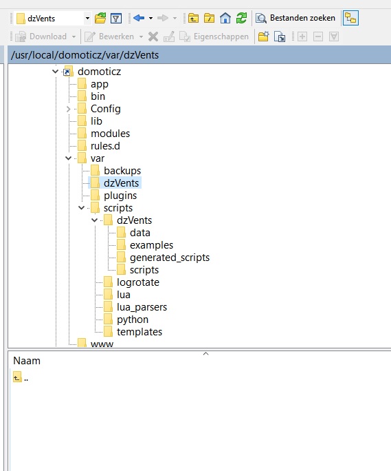

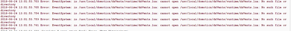

i removed the line in etc/passwd and rebooted.
everything still worked
upgraded to the latest stable 4.9700 (upgraded from 3.8720)
domoticz did not run like it should so i stopped the package and restarted it.
Domoticz now runs and works but it seems something has changed regarding dzVents
it can not find the dzVents.lua file
it is looking at /usr/local/domoticz/dzVents/runtime/dzVents.lua
however when i check the new install has put it at /usr/local/domoticz/var/dzVents/runtime/dzVents.lua
is there any way to correct this?

until fixed use following workaround:Gravityz wrote: Sunday 24 June 2018 13:28
sudo mkdir /usr/local/domoticz/dzVents
sudo mkdir /usr/local/domoticz/dzVents/runtime
cd /usr/local/domoticz/dzVents/runtime
sudo cp -r /usr/local/domoticz/var/dzVents/runtime/* .
if everything works and is stable
sudo rm -r /usr/local/domoticz/var/dzVents/runtime

ok, looking at your advice it looks like a bug which needs to be solved
tried it. it now finds dzVents.lua but is generating an error on line 33
2018-06-24 13:57:51.196 Error: EventSystem: in /usr/local/domoticz/dzVents/runtime/dzVents.lua: /usr/local/domoticz/dzVents/runtime/dzVents.lua:33: attempt to concatenate local 'triggerReason' (a nil value)
this is at line 33
utils.log('Event trigger type: ' .. triggerReason, utils.LOG_DEBUG)

Gravityz
- Posts: 652
- Joined: Wednesday 16 December 2015 19:13
- Domoticz version: 2025.1
it creates the
/usr/local/domoticz/var/dzVents folder but it is empty
it creates the
/usr/local/domoticz/var/scripts/dzVents folder, this one in filled with directories
i installed a earlier version 6.2 9672 and that one also fails to install DZvents
i am biginning to think this problem is in all the 6.2 versions.
if i install an old 3.8720 version it does install dzvents
it creates the
- jumbotroll
- Posts: 793
- Joined: Tuesday 13 January 2015 14:36
- Location: Oslo,Norway
If you go to ->setup->about you don't have:Gravityz wrote: Sunday 24 June 2018 20:11 it creates the
it creates the
Version: 4.9700
Build Hash: a3a4590-modified
Compile Date: 2018-06-23 16:24:51
dzVents Version: 2.4.6
Python Version: None
Uptime: 19 Minutes, 40 Seconds
Did you try to create a dzvent script and run it?
If you make a script with Setup -> More Options -> Events and generate a script, you should see it in folder:
/usr/local/domoticz/var/scripts/dzVents/generated_scripts
It is some changes in later source code and have nothing to do with DSM 6.1 or DSM 6.2.

Gravityz
- Posts: 652
yes i have that exact info so that part is right.
if i check right after installation the dzVents directory is there but nothing in it(no runtime)
after restoring database it is still empty.
i can create a script and it appears in the generated_scripts folder
it even tries to run it(with the error that it can not find the dzvents.lua file
somehow it also points to the wrong folder(probably because in the old versions it was under /usr/local/domoticz/dzVents
however i did a brand new installation so how can it still be searching in the wrong directory
2018-06-24 21:02:32.085 Error: EventSystem: in /usr/local/domoticz/dzVents/runtime/dzVents.lua: cannot open /usr/local/domoticz/dzVents/runtime/dzVents.lua: No such file or directory
if i install 3.8720 the var/dzVents directory is filled
