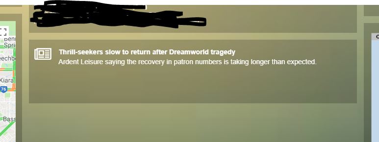

Hi, i have found the following bugs
1. News Feed not auto resizing on any page other than page 1. so page 1 will size to suit 1 articles and scroll though however any other page will just list all the articles
2. domoticz Light/Switch, Selector Switches are not displaying correctly. one that uses a drop down menu displays seemingly random characters and the other displays on buttons. both function correctly in domoticz its self. PC Speaker output originates from a dummy piece of hardware and triggers http messages the other is from a plugin (viewtopic.php?t=21024) ... not sure if that makes any difference

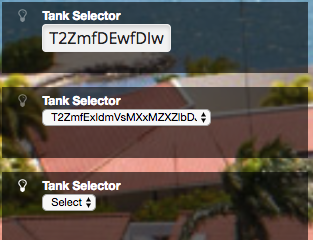

For me also the "dummy" selector switches are not working any more. I've added the switch in several ways, but no succes.
Schermafbeelding 2018-09-07 om 20.58.51.png (113.86 KiB) Viewed 7803 times

pollefinario wrote: Friday 07 September 2018 20:58 For me also the "dummy" selector switches are not working any more. I've added the switch in several ways, but no succes.
You might want to check main.js and see this line
var names = device['LevelNames'].split('|');
and change it into:
var names = atob(device['LevelNames']).split('|');
MAKE A BACKUP FIRST
pollefinario
Posts: 21
Joined: Wednesday 10 February 2016 12:40
Re: Dashticz - Bug report
Post by pollefinario »
Great, thanks a million, that seems to be the trick!
