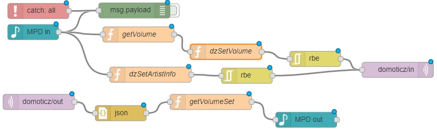

after few month in whitch I tested the connector I would start moving to something else.
The service experienced hangs, disconnections and a wired loop while changing volume...
So.. I start interesting in MQTT, and NodeRed and I found a way by which the service is much more stable with less scripting, and use the MPD server on volumio instead of socketIO.
The result is that it works like a charm with no script at all!!!.
So...
trow away the python, lua/dzVents script and use MQTT and Node-Red instead.
User MPD control to gather info in realtime and MQTT do send/receive Domoticz command
The presents (playlist and play controls) will run as HTTP actions while the Volume slider will be used by the MQTT interface.
I'll update the nodered flow soon (mine uses a dashboard UI also.... so I would like to duplicate it in a clean way)
MQTT is a REALLY good solution and widely open to almost everything!!!
ciao

Ciao,
here it is...
please note you have to configure:
MPD in and MPD out with the IP:port (6600) of your volumio device
domoticz/out and domoticz/in with the IP and topicz of your mosquitto server (could be the same as Domoticz box)
in dzSetVolume - set the ID for the custom device for volume control (a dimmer)
in dzSetArtistInfo - set the ID for the custom device for text (act as a display)
in getVolumeSet - set the ID for the custom device for volume control (a dimmer) - the same as per dzSetVolume
here is how it woks:
MPD.in is activated at any chanage in the volumio state
getVolume acquire the volume status and then dzSetVolume convert it into the json formatted command for MQTT, rbe is used to ensure no duplicated values are sent and finally it goes through MQTT to domoticz
dzSetArtist convert Artist Name and song Title into a json formatted command for MQTT rbe is used to ensure no duplicated values are sent and finally it goes through MQTT to domoticz
in the meantime, domoticz/out push ALL status form domoticz, so it gets converted into a JSON and then getVolumeSet intercept the volume device and update volumio via MPD
getVolume and dzSetVolume could be merged into a single function, but I have a dashboard also, so, my layout is quite different (i've created this one only for this post :P :P )
here is the nodeRed flow to import from clipboard
