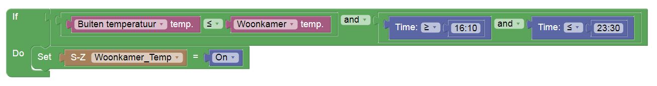

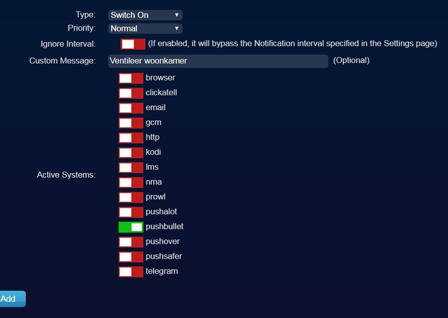

I'm trying blocky to have domoticz send me a notification when the outside temperature gets below the temperature inside the house, so I have to start opening doors and windows. I'm using blocky as I have no idea how to program in Lua. However, I can't get it to work properly.
I have setup a virtual switch (Woonkamer_Temp) that is set to ON when outside_temp < livingroom_temp AND time is between 18.00-2330 hrs
In the virtual switch (Woonkamer_Temp) I have setup a notification when it switches to ON
The switching part works like a charm, however I keep getting notification every minute or so. I can see in the log that the 'Woonkamer_Temp' switch is polled all the time, hence sending a new notification every time. How can I prevent domoticz from doing that? I just want to have a notification one time. Can't get it to work in blocky.
Version 1 Version 2
Version 1 Version 2

Your blockly does switch your notification triggerdevice every time the temperature condition evaluates to true.henk99 wrote: Thursday 02 August 2018 16:26 I'm trying blocky to have domoticz send me a notification when the outside temperature gets below the temperature inside the house, so I have to start opening doors and windows. I'm using blocky as I have no idea how to program in Lua. However, I can't get it to work properly.
Using the checkFirst option in dzVents you can prevent that . This small dzVents script should do the job.
