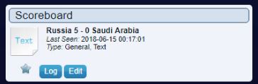

Screen Shot 2018-06-16 at 13.23.44.png (41.87 KiB) Viewed 3504 times
Thanks. I don't like soccer/football but this things are funny to play with.

						local score = (hgoal..' - '..agoal)
						local winner = tostring(scoreData[tc].winner)
						if winner == 'Draw' then
						   show = ('Draw '..home..' '..hgoal..' - '..agoal..' '..away)
						   show = ('Match won by '..winner..' with '..score)
						tc = tc + 1
					if status == 'future' then
					    show = (show..' KO '..hour..':'..minute)
					    tc = tl + 1
				until tc > tl
					if show ~= prevboard then
					    print ('result '..show)
						board.updateText(show)
Line 56 (hour = hour + 1) should be changed for different timezones (mine is UK BST).
MikeF
Posts: 350
Domoticz version: V2022.2
Location: UK
Re: World Cup Scoreboard - new version
Post by MikeF »
I've added the elapsed match time - although this will lag, as the script runs every 3 minutes:
