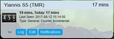

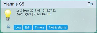

With this script:
if you create a "General, Counter incremental" with a name of a switch prefixed by " (TMR)" this will count
when your switch is ON.
Domoticz Installation instructions:
- Save this script as "script_time_switch-timer.lua" on "Domoticz/scripts/lua" folder
- Add a new "General, Counter incremental" with a name of a switch prefixed by " (TMR)" for each switch you want to time.
example:
Timed switch:
Timer device:
Hope you like it!!

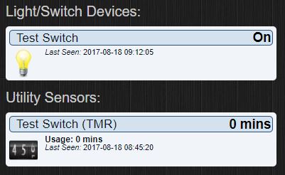

Thanks for the script, I thought i would give it a try, but think I am missing something, it is counting way to fast.
Does it only count from the time you start running it or does it do a count back using the logs?
I created a dummy incremental counter, the Type is set to count, the Offset 0 and I entered Time if Quantity and mins in Value Unit.
Thanks,
Wob

Hello Wob76.
LUA scripts executed every minute on Domoticz. So, this script just perform the calculations (discovering "(TMR)" devices and their counterparts)
and increasing "*(TMR)" value by 1.
In fact, starts to count as soon as run it.
Your counter (from what you said) seems correct. Be sure to name this device correctly <name of switch>+"(TMR)".

Thanks for the reply.
It seems to match up fine, I can see it detected in the log, but after about 60mins from install my counter is showing 249mims, the switch has been on only about 3 hours all day, any idea why it would count to much?
Thanks,
Wob

OK, I enabled debugging in the script and I can see it firing, but it is only detecting the switch, it is not counting it as on.
2017-08-18 09:15:00.032 LUA: Timer Device Detected:Test Switch (TMR)
2017-08-18 09:16:00.041 LUA: Timer Device Detected:Test Switch (TMR)
I am running Domoticz Version: 3.8280

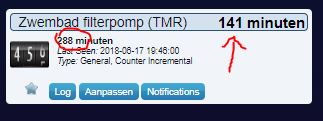

thank you for this script, works rather good but when I try to use the value of the incremental counter I get the total incremental value (total of all days, not of today).
I would like to work with the total of today... is this possible? How?
I'm using following syntax:
tonumber(otherdevices["Zwembad filterpomp (TMR)"])
where "Zwembad filterpomp" is the device from what I would like to know how long it was "ON" today..
but it returns, as already said, the total of all days.
Thx for your help

This has always been the behavior of counters in Domoticz. It shows the daily increment in the dashboard, but I have never found a way to retrieve this number from the device in LUA.
I ended up maintaining the daily status in a separate device, I used a dummy device of the type "Custom Sensor" for this. I increase the value of this sensor every minute that the corresponding device is on (just like the total counter), and I set it back to 0 every night at 0:00h using a timer script.

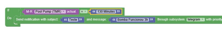

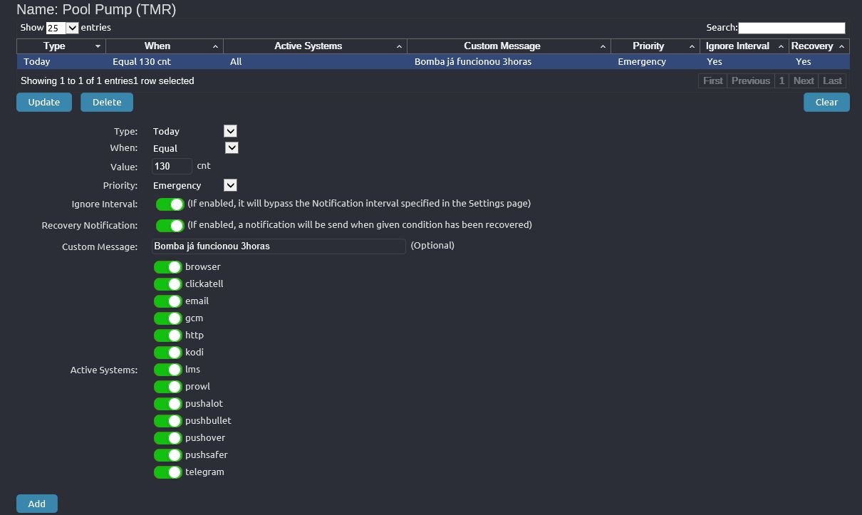

Using this script to easilly know how much time my pool pump has been runing for each day, but havent figured out how to set it up to send me a message when it has reach a certain time, have tried several ways none of it works on this dummy device.
tried with just 130, with 130 minutes, the type tried Today, tried Update.
And yes i have notifications working on other switches/counters

I'm trying to use this timer function with version 4.10265, but cannot seem to get is working.
I have:
1 switch called test; light/switch, Switch, on/off
1 utility called test (TMR), General, Counter Incremental, type is Time, counter divider 0, Meter Offset 0
I can see the event triggered in the log but the utility shows a "?" and keeps at 0. When i change the utility to counter instead of time I do see increase of the number but no time is showing just an integer.
Anyone who is able t help?
Cheers,
Hemant
