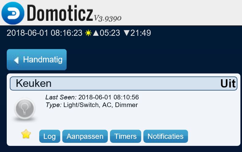

Hello JumboTroll,
I'm a very happy user of your package (broadwell 6.1 with python) on my Synology. I hope you can help me with this one: since recent update it seems that the slider is missing on all my dimmer-switches. I can put the switch on and off but I can't change the intensity anymore. Tried on several devices, several browsers and apps but nothing works. Any tips?
See attached image:
Faulty dimmer
Faulty dimmer
Thanks in advance and I hope you will keep up the good work for a long time to come.
Michael

Maybe a small bug in your version. It is available in my version V3.9483. I use OpenZWave USB. Wondering what type of device you use.
Synology with Domoticz build (V2024.7) in Docker

I'm using a RFLink USB device. And I have to correct myself: I'm not on broadwell als stated earlier but on Cedarview (sorry :oops: )

UPDATE: The problem with missing sliders in dimmer switches is solved by upgrading to 3.9558, wich was posted yesterday. Thanks everyone.
