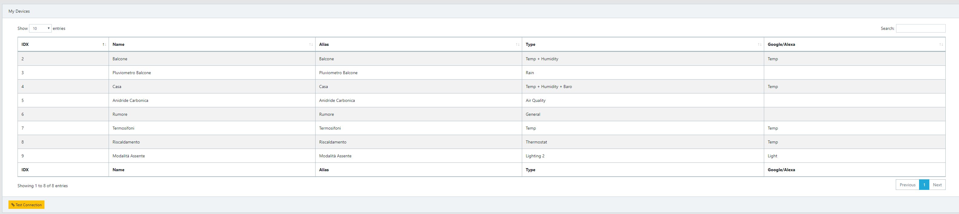

NeoMod wrote: Sunday 03 June 2018 0:17
Obviously – and I guess this is normal now – If I try to add Controlicz to my Google Assistant account It will not retrieve my device.
What do you mean by this, how does GH responds when you say "sync my devices" ?
Controlicz is linked to your account?
Madgeni
Posts: 1571
Re: Controlicz - Domoticz to Google Home/Assistant integration
Post by Madgeni »

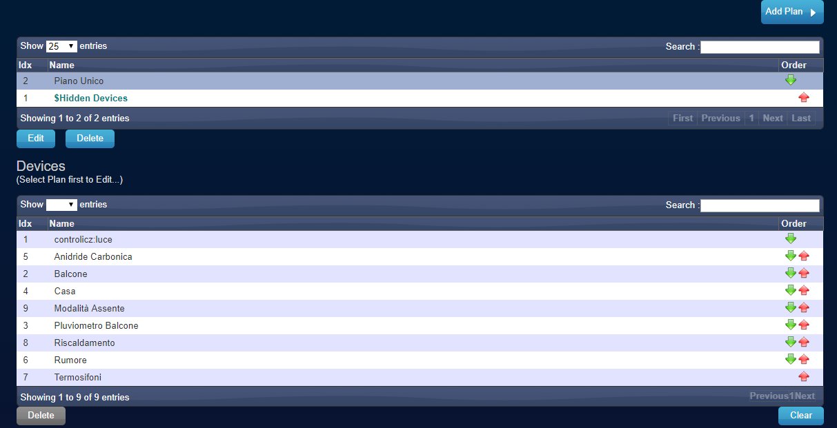

NeoMod wrote: Sunday 03 June 2018 0:17 Hello,
first of all than you very much for the hard work on Controlicz and Domoticz.
I’m a novice at this, so maybe I’m doing something wrong and hence I’d like to ask your advice.
I have a single device in Domoticz, a light switch, which works perfectly fine.
The problem is – apparently – that Controlicz can’t see my device: I did all the required steps (created a Floorplan an added the device to it and named the device “controlicz:light”) but it won’t appear under My Devices on Controlicz.
I hope you help me understand what I’m doing wrong.
Thank you in advance!
Hi and welcome :)
You need to create a Room Plan in Domoticz, not a Floor Plan (obviously you can have Floor Plans, but Controlicz works only with devices in Room plans - it's like an extra filtering system of control for you).
Try that, and let me know how you get on
NeoMod
Posts: 21
Joined: Friday 07 July 2017 22:02
Domoticz version: Latest β
Location: Italy
Post by NeoMod »

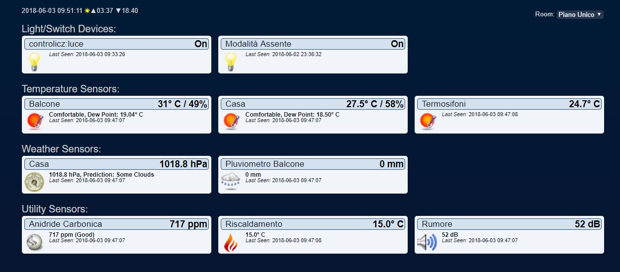

Madgeni wrote: Sunday 03 June 2018 9:51 Hi and welcome :)
Hi Madgeni, thank you so much for your help.
Indeed I was missing the Room Plan creation (my bad) so I created one and added all my devices to it: from what I can see in Domoticz it seems to be working perfectly.
But still, I can't manage to synchronize my light switch via Controlicz: I've also added my Netatmo to test with more sensors, and those are correctly reported by Controlicz to Google Assistant.
(I have an old model of NetAtmo Weather Station that did not have the dedicated chip yet, hence I need Domoticz+Controlicz to read its values using Google Assistant)
P.S. sorry if the devices names are in Italian in the screenshots.
NeoMod
Posts: 21
Location: Italy
Post by NeoMod »

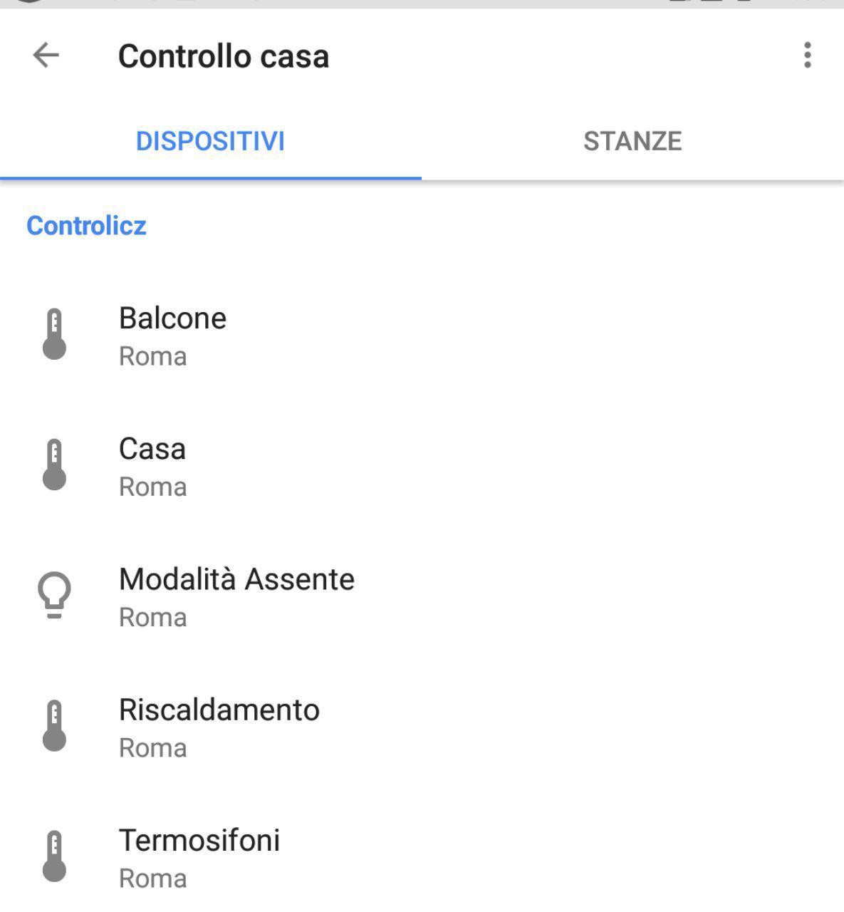

Venzent wrote: Sunday 03 June 2018 9:34
Thank you for your help Venzent.
What I meant is that upon adding the Controlicz account to my Google Assistant (after the Allow Total Control prompt to be precise) no device is recovered/found so Google won't let me add anything.
To double-check my procedure I've added my NetAtmo to Domoticz and paired again the Controlicz account with Google Assistant: this time all the supported sensors where recognized and Google asked me to add each device to a Room.
If I issue the "Sync my devices" command I receive a positive feedback ("Ok, I'm syncing Controlicz") but nothing changes.
Yes, Controlicz is linked to my account and inside the Devices panel on Controlicz website I can see all the NetAtmo sensors, but there is no light switch.
Please Note: that "switch" you see, named "Modalità Assente" actually is not a switch but the NetAtmo Thermostat "Away Mode". I had to call this way because anything with the word "Thermostat" in it results in an error when I ask Google to read the temperature or set a temperature. (The error is: "I'm sorry but I can't understand which device you are talking about"). Instead calling the Thermostat this way enables me to set the "Away Mode" as if it were a simple switch.
