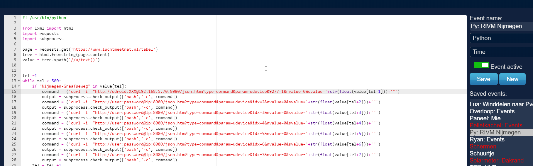

Dear ... connot get it to work...
Did intstall;
Did the cron:
Did the script:
Did set the login and ww to my versions..
Did change the dvice idx for my devices:
Only log data and the device is not changing
What do i mis?

When i do the script from putty.
I get this data....
Almost there???
Only when i try a other station my data is still the same.. grrr..

Hello Derik, not sure where is goes wrong, but what you see is the output of the lines:
command = ('curl -i "http://user:password@ip:8080/json.htm?t ... alue='+str(float(value[tel+1]))+'"')
output = subprocess.check_output(['bash','-c', command])
Because these lines are winthin the "while loop" it might suggest that some data is downloaded from luchtmeetnet and that the Nijmegen station is found. What you don't see in this output is the value it uploads. Suggest to add debug information like:
print tree at line 10
and
print value(tel) at line 15 and value(tel+1) at just underneath it.
and
