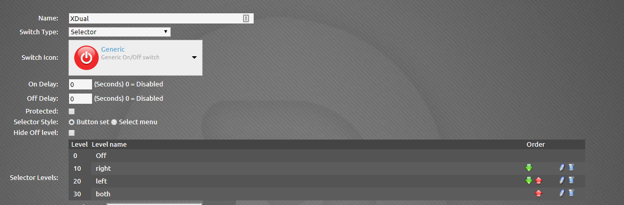

Is this the same / similar as the WXKG02LM ?
I have that one setup as selector and control the actions with dzVents script.
   on = { devices = { "XDual" }           },
   execute = function(dz, switch )
      if switch.state == "left" then
            dz.devices("Kastenkamer lamp").toggleSwitch()
      elseif switch.state == "right" then
            dz.devices("Kastenkamer rolluik").switchOn()
      elseif switch.state == "both" then
        dz.devices("Kastenkamer rolluik").close()
        dz.devices("Slaapkamer rolluik").close().afterSec(5)
