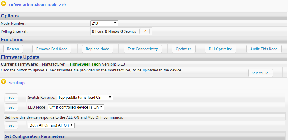

Only thing I'm trying to do is turn off the nightlight on it! The feature is with the GE 12722 light switches and from looking at the Homeseer site, it should be supported Image. With Homeseer it just says "LED Mode".
Any ideas how to get this included in Domoticz?
