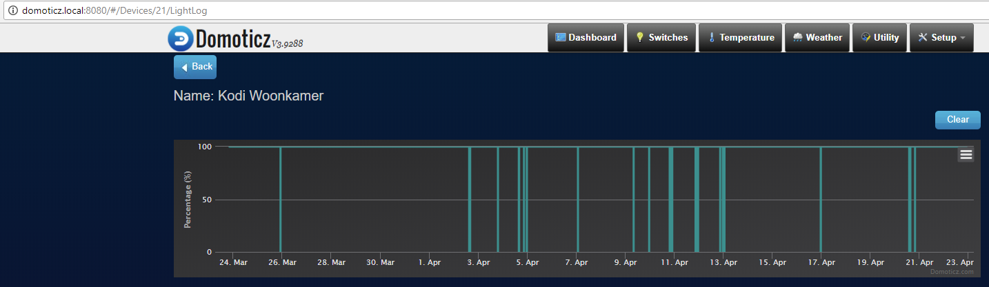

I must be going mad: when running domoticz on port 8080 it is not possible to switch icon in edit mode of device and the log is showing less. If I start on port 8081, all is ok...
Thanks for any advise on how to resolve this... Not really a problem to run on 8081 but it bugs me that I can not find the reason...

And the log:
- CaptureLogNOKport8080.PNG (78.38 KiB) Viewed 921 times

Hm, just noticed that giving the host a different name also solves the issue. I guess the webserver does not like the host to be domoticz as it maybe uses it internally as well fro some check on port 8080?
Renamed the host to domoticz-prod.local and know am running on port 8080 with the proper edit and log functionality...
Still interested to know what is really going on. Would be great if someone was able to explain/elaborate?

Try clearing your browser cache and appcache (two different things)

Ok, I will give that a try!gizmocuz wrote:Try clearing your browser cache and appcache (two different things)

Ok, my bad: clearing the appcache did it! Must admit I was not aware/stumbled upon the existance, of that cache. Must browse more topics.
@gizmocuz: Thanks for solving this issue for me!
