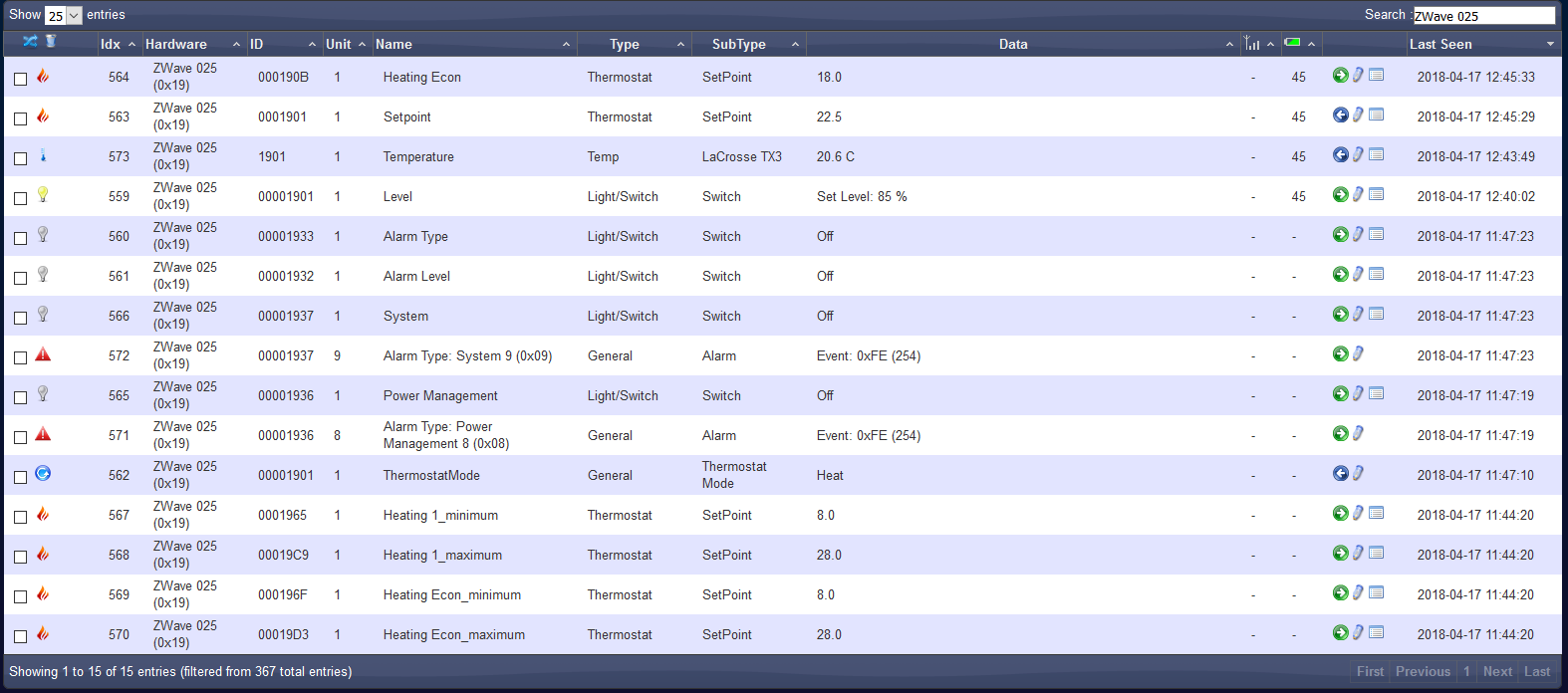

Hi, Today i installed my first spirit valve, All parameters are available (After placing the xml files)
but how can the spirit generate heat demand, i want to connect a zwave-switch (QUB_ZMNHID1 pending at robbshop) in parrallel to the Nest contact on my burner.
Do I need to build a script or can i just associate the output of the spirit to the switch input?

Anyways, here is my attempt. I backported thermo v3 related changes to libopenzwave 1.4 wich is required for spirit to work correctly. Follow the instructions on the domoticz wiki for compiling openzwave and domoticz here. Apply the patch to the libopenzwave source and compile it, then compile domoticz against your homebrew libopenzwave. You will have to remove your existing spirit nodes and re-include them. Now you should have a quite few extra options for controlling the thermostat.
The patch also contains required xmls for spirit thermostat. You do need to copy the file config/eurotronic/eur_spiritz.xml to your domoticz installation if you don't have it already. Ohh and don't forget to add a reference to the xml.

screenshot options
screenshot options

pipiche wrote: Friday 15 June 2018 16:33 I'm using Tobias' repository in reference to this issue : https://github.com/OpenZWave/open-zwave/pull/1341
But still I don't have conclusive status
- Fibaro FGT-001 doesn't report thermostat temperature. If I set a temperature on the Thermostat itself I don't see this setpoint coming back to Domoticz .
- SPIRIT : Looks like the setpoint value is not displayed on the Thermostat screen ? Is that expected ? And if I set a temperature on the Thermostat itself I don't see this setpoint coming back to Domoticz .
Hi pipiche,
If you are using my hacky thermov3 backport, you have to remove existing spiritz devices first. and re-include them to have domoticz recognize them with the new options.
If openzwave does not detect the thermov3 options it might be that domoticz is linking to an old library where there are no thermov3 changes.
If memory serves me well, the thermostat will display the setpoint and when changed it will report to domoticz. It is possible you have to change to poll to request updates from the nodes. I will check this weekend what it does.
Regards,
William
