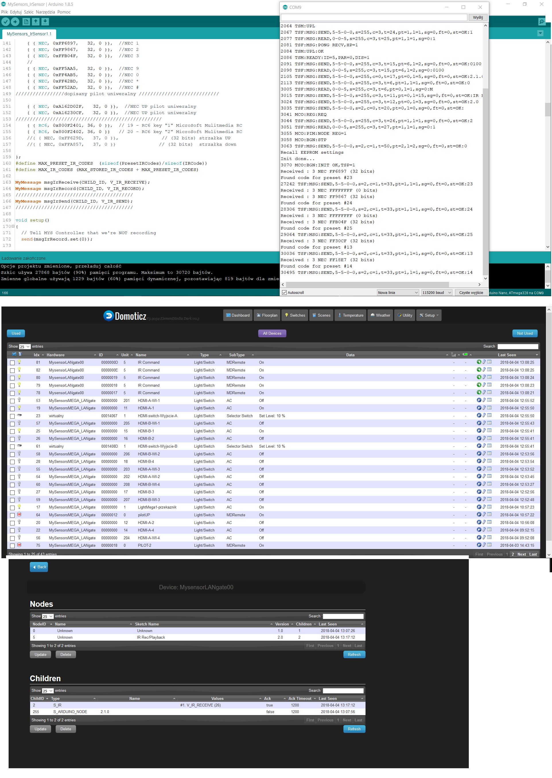

Hello
Using the example sketch from the https://www.mysensors.org/build/ir
, I managed to program a few pilot buttons in the domotic. (IR codes are of course entered in the section: IRCode PresetIRCodes [] = (...).
I would, however, "upload" a few IR codes to Domoticz, which would control my TV and AV via the IR diode from the Domoticz level.
ir problem.png (358.98 KiB) Viewed 2501 times
In this example, there is the sendRCCode () function, which, in theory, sends an IR code (previously uploaded to Domoticz) via IR diode, if of course it will get
message.type == V_IR_SEND.
I added in arduino sketch an additional declaration:MyMessage msgIrSend (CHILD_ID, V_IR_SEND);

but in Domoticz there was no additional Device that would be responsible for sending IR codes.There is only one children: V_IR_RECEIVE.
I think I probably need to do an additional Dummy Switch, which will send an IR signal transmission command to the gateway / node using JSON.
I'm thinking about it for a long time and I have no idea how to do it in DOMOTICZ.
Please help me how to do it.
lamptah
Joined: Tuesday 04 September 2018 3:37
Re: how to playback IR (irsend)
Post by lamptah »
Hello, not sure if you are still looking, but if anyone else comes across this ...
There was a bug in domoticz that prevented the sending of any codes via V_IR_SEND. That is fixed in the latest beta, (commit https://github.com/domoticz/domoticz/co ... 4dcc1543b3). With this fix, any code that was first received by domoticz (and created in the hardware) can now be sent back again by activating the switch that was created. This will play back the exact code received, in your screenshot code 26. It is handled by the same child that manages V_IR_RECEIVE.
