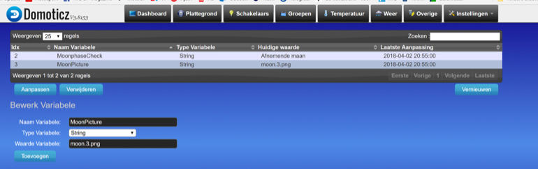

Having a strange problem with the moon pictures since today.
Dashticz gives a broken image
I checked the user variable in Domoticz and the image with MoonPicture was indeed a non exiting number.
I changed the image line to the right one and the moon picture was back in Dashticz.
After a WU update the pucture was broken again. Changing WU site did not help.
Does anybody know what is happening here?

Beschuitje
Posts: 32
Joined: Saturday 24 February 2018 12:07
Re: Dashticz - Module Moonphases
Post by Beschuitje »
When looking to the script, you can guess that it supposed to use only half of moon pictures (0->50 then 50->0).
You are right but that was not the problem. The first 9 pictures in the moon folder are 01, 02, 03 etc. Donoticz started using 1, 2, etc. The 0 fell off and i wunder why.
I solved it by changing the image names of the first 9 moon pictures. Now wait and see what happens when he starts using 10, 11... ;)

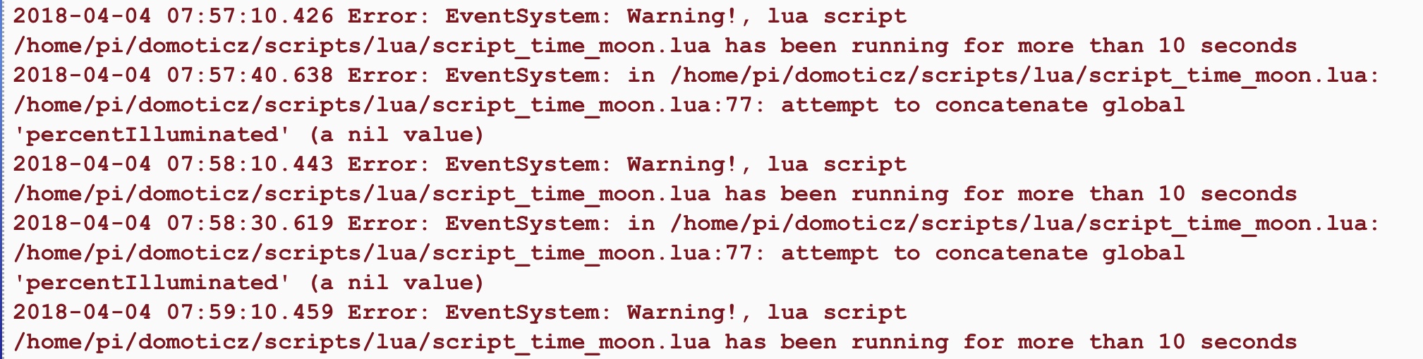

And the problems are changing...
I now get errors in the log about the script
It loads a moon picture but its the wrong one. Moon percentage is ok (85%) but the picture does not match this.
It gives almost a full moon (picture 6)
Will see if deleting the script and re install after a reboot of the Pi helps. It had worked for more than a month so very strange. Haven’t updates Domoticz and or Dashticz in a while so this can’t be the problem.

I have problems with the scrips my log say this:
2020-04-17 16:20:00.369 Error: EventSystem: in Maanfase: [string "-- Variables to customize -------------------..."]:77: attempt to concatenate a nil value (global 'percentIlluminated')
2020-04-17 16:21:00.020 Status: LUA: Moonphase - Collecting data from: http://api.wunderground.com/api/REEKSME ... eppel.json
2020-04-17 16:21:00.322 Status: LUA: Moonrise: --:--
2020-04-17 16:21:00.322 Status: LUA: Moonset: --:--
2020-04-17 16:21:00.322 Error: EventSystem: in Maanfase: [string "-- Variables to customize -------------------..."]:77: attempt to concatenate a nil value (global 'percentIlluminated')
I made a weatherstation in Wunderground, but it is not a real one. Maybe that is why i get no values. Is there another option to get data?

RezaRose wrote: Friday 17 April 2020 16:23 I have problems with the scrips my log say this:
You are in a pretty old Dashticz thread. I guess you have a Domoticz related question, so it's better to post it somewhere in the Domoticz forum.
If you want to display the moonphase in Dashticz I probably can help.
