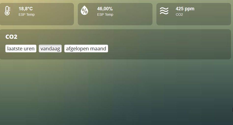

javed222pi wrote: Sunday 01 April 2018 0:53 Hi all,
I’m try to insert an CO2 (air quality) graph, in my dashticz dashboard, but I cant …
How I must to do? I must to edit graphs.js ? but how??
Please help
I can get the basiscs of the graph with this code:
//Luchtkwaliteit
blocks[255] = {} //CO2
blocks[255]['width'] = 4;
blocks['graph_255'] = {} //CO2
blocks['graph_255']['width'] = 12;
But the result is this:
2018-04-03 18_13_01-CONFIG.js — C__Users_Stephan_AppData_Local_Temp_scp10343_home_pi_domoticz_www_da.png
2018-04-03 18_13_01-CONFIG.js — C__Users_Stephan_AppData_Local_Temp_scp10343_home_pi_domoticz_www_da.png (99.24 KiB) Viewed 4200 times
If I check the json (x.x.x.x/json.htm?type=graph&sensor=counter&idx=255&range=day) in Domoticz this is my data:

javed222pi
Joined: Monday 29 August 2016 13:29
Domoticz version: 3.4834
Location: Argentina
Post by javed222pi »
Hi Stephan83!
I have exactly the same problem
The sensor data are correct, but the graph shows no information.
