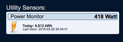

So i've been able to graph my energy usage using the owl micro but i wondered if theres anyway i can get domoticz to automatically work out how much it's costing me.
i pay 14.89p per unit.
many thanks
Screen Shot 2018-03-28 at 20.55.14.png (19.13 KiB) Viewed 8982 times

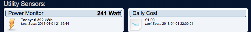

Screen Shot 2018-04-01 at 22.00.26.png (32.14 KiB) Viewed 8656 times
all working great here :D thank you so much MikeF
i had to specify the python3 path to get it to work in cron using the following
*/1 * * * * /usr/bin/python3.5 /sbin/energy_cost.py >> /var/log/energy_cost.log 2>&1
added a log output for errors when the cron job runs
next thing to work out would be a weekly and monthly cost output :D
