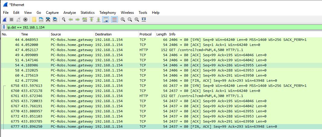

I've placed my curl folder here c:\curl\bin\curl.exe, and added this folder to system variables for both user and system PATH.
I can also see the GET command using Wireshark when using a windows 10 cmd window with...
...but using folowing LUA code doesn't!
Anything else I need to check? Tried rebooting but think it's something to do with security, system variables etc.
Rob
Re...
I have exactly the same problem!But, when I try the same command in domoticz script : os.execute('curl..http://169.254.1.1/status.xml') it doesn't work.
and it does work with the ESPEasy E12 device as I can see the PWM change on my scope on pin 4 (GPI04/D2)
runcommand = "curl 'http://" .. IP .. "/control?cmd=PWM," ..PIN.. "," .. CalcValue .. "'";
-- runcommand = "http://" .. IP .. "/control?cmd=PWM," ..PIN.. "," .. CalcValue .. "";
os.execute(runcommand);Rob
