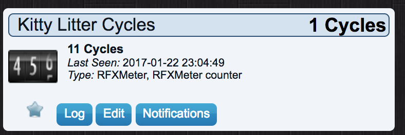

I bought the ScoopFree Ultra kitty litter and added a Z-Wave magnetic door sensor at the end part to sense when the "storage section" opens and closes.
Each time the cat uses the kitty litter it updates a counter in Domoticz so I can tell when the kitty litter needs changing (after x cycles):
The device name for the magnetic door sensor is: Kitty Litter
The device name for the counter sensor is: Kitty Litter Cycles
You may need to change the "Closed" to "Open" depending on your setup, it's a pretty simple script.
Screen Shot 2017-01-22 at 11.11.58 pm.png (64.86 KiB) Viewed 3411 times
