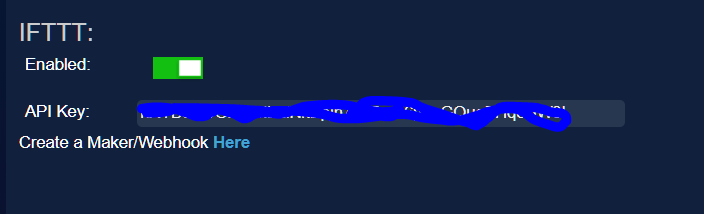

Trying to setup my domoticz to google home mini.
Im inside domoticz using v 4.10915 when i enable IFTT and put the API KEY and Aplly setting i get:
Invalid location settings...
Can someone help me?
Re: IFTTT and Domoticz
daniellejorge wrote: Wednesday 19 June 2019 17:03 Trying to setup my domoticz to google home mini.
It's about this location in the settings

waaren wrote: Wednesday 19 June 2019 18:32
Omg, you are a god!!! Thank you very much!!! :D :D :D
