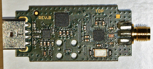

Without the plugin I am just able to monitor the Jablotron (Armed/Disarmed) via de PGx/y port.
https://gitlab.labs.nic.cz/turris/domot ... Dongle.cpp
https://gitlab.labs.nic.cz/turris/domot ... loDongle.h
And for the hardware types:
{ HTYPE_JabloDongle, "Jablotron USB Turris Dongle" }
https://gitlab.labs.nic.cz/turris/domot ... XNames.cpp
https://gitlab.labs.nic.cz/turris/domot ... RFXNames.h
friend class CJabloDongle;
https://gitlab.labs.nic.cz/turris/domot ... rdware.cpp
https://gitlab.labs.nic.cz/turris/domot ... Hardware.h
HTYPE_JabloDongle
https://gitlab.labs.nic.cz/turris/domot ... Server.cpp
#include "../hardware/JabloDongle.h"
https://gitlab.labs.nic.cz/turris/domot ... worker.cpp
But it looks like if you actually need som sort of a separate TURRIS USB dongle and not the JABLOTRON PC Interface to get it up and running.
