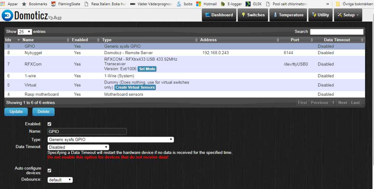

Maybe you should try another web-browser. This sounds weird, but sometimes the browser creates problems with Domoticz. I think it is cache or cookie related. For instance, try with Edge to see if this helps.

Yes, yes!
I tested with Chrome and voilà: the Auto configure devices checkbox and Debounce field both appear! Since I prefer to keep using Firefox I cleared the cache and both fields are visible now in Firefox too. Somewhere on this forum I read a post about clearing the browser's cache.
Thank you again. Now I can continue with my little project of defining an input and so on.
