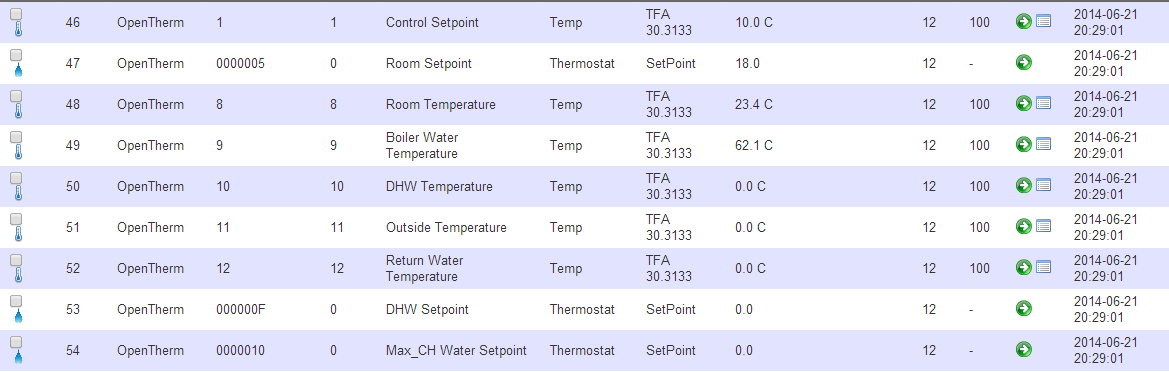

20:08:23.523226 Command: SW=54
20:08:23.541157 SW: 54.00
20:08:45.007171 T80190000 Read-Data Boiler water temperature: 0.00
20:08:45.148995 BC0191419 Read-Ack Boiler water temperature: 20.10
20:08:46.010132 T00090000 Read-Data Remote override room setpoint: 0.00
20:08:46.032068 R10383600 Write-Data DHW setpoint: 54.00
20:08:46.145500 BD0383600 Write-Ack DHW setpoint: 54.00
20:08:46.160374 AC0090000 Read-Ack Remote override room setpoint: 0.00

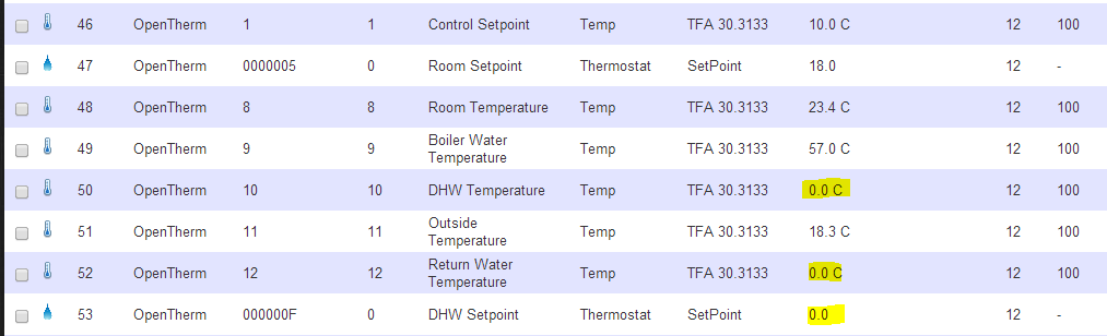

I've got the issue with the DHW and CH setpoint. Both jump back to the original value
DHW = SW
Max CH = SH
DHW = SW
Max CH = SH

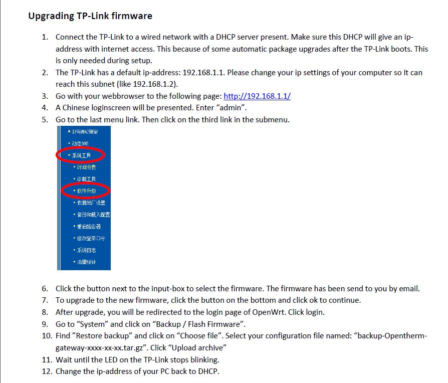

Re: [120] opentherm gateway
Hello
I try to get the opentherm gateway in combination with the lan/wifi interface working. I have tried to get communication going via port 1001 as the manual tells me. Is there somebody who has this setup (otwg + tplink 703) working in Domoticz? And maybe can confirm i' am using the right port?
Hello Sandor
Thanks a lot for your reply! I appreciate it.
I get errors that connection gets refused in Domotiticz log: I'am not entirely sure I configured the TPlink startup script correctly to be honest. I bought it as a kit and I followed the documentation which came along with it. The TPlink had to be flashed with "openWRT" firmware and configured as such.
This is the document: Thanks a lot
John
John

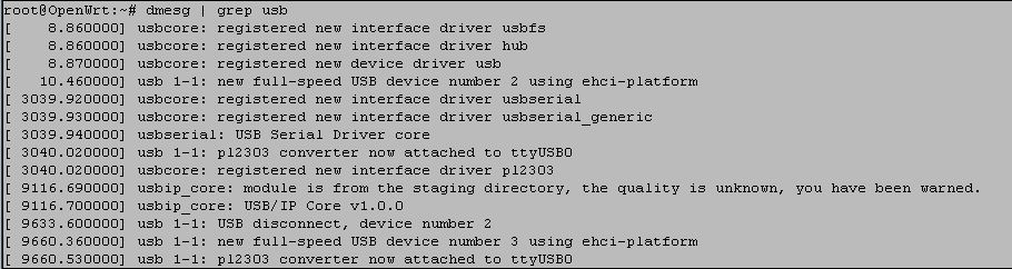

I'am not very succesful yet;
Both the packages are installed ("kmod-usb-serial-pl2303", "ser2net") as the luci webgui of the Openwrt tells me.
Also I can find the ser2net.conf file with the string as you wrote below.
The dmesg grep shows me a connected device PL2303 and when I disconnect the usb connector it shows the PL2303 disconnected. I don't know if this is the right value for the actual OTGW.
I build the gateway myself and I do know that the gateway itself is working OK because the windows application "OTmonitor" works good over USB.
Thanks for your support
Best Regards
John
Best Regards
John

10.180000] ehci-platform ehci-platform: USB 2.0 started, EHCI 1.00
10.180000] hub 1-0:1.0: USB hub found
10.450000] ohci_hcd: USB 1.1 'Open' Host Controller (OHCI) Driver
10.530000] usb 1-1: new high-speed USB device number 2 using ehci-platform
10.590000] USB Serial support registered for generic
10.680000] hub 1-1:1.0: USB hub found
10.690000] usbserial: USB Serial Driver core
10.740000] USB Serial support registered for FTDI USB Serial Device
10.750000] ftdi_sio: v1.6.0:USB FTDI Serial Converters Driver
10.780000] USB Serial support registered for pl2303
10.790000] pl2303: Prolific PL2303 USB to serial adaptor driver
10.980000] usb 1-1.2: new full-speed USB device number 3 using ehci-platform
11.090000] usb 1-1.2: pl2303 converter now attached to ttyUSB0
A well you should be nearly there.
check /etc the ser2net.conf should be there.
if not just create one
touch ser2net.conf
sudo nano ser2net.conf and enter 1 line
1001:raw:15:/dev/ttyUSB0:9600,NONE,1STOPBIT,8DATABITS
save the file and now run ser2net.
Try again in Domoticz.

I still have some 0 values.
- Still some 0. values
- John.PNG (23.25 KiB) Viewed 5021 times
Hello
Well actually i also have some zero values like you do, except for the return water temperature; that one shows an actual value. On top of that I have to deal with another lttle issue; cause when I got home from work I noticed all the OTGW devices in red state. The running log of Domoticz showed me an "end of file" error, don't know where that comes from, but after a restart of the TPlink and the start of the ser2net process things started to work again. Maybe some log which is enabled or so? So still stuff to do I guess
I flashed version 4.0.1 in my OTGW
Cheers
