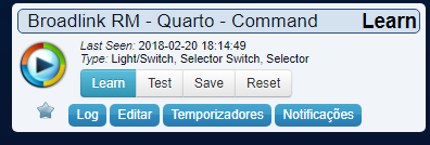

I'm trying to import the Plugins from Broadlink, but I do not know how to do it.
A unica tela que consigo é:
The attachment Learn.png is no longer available
I can connect normally to the Broadlink, however, it does not show this screen: "WebStart" "Generate" "Import" "Reset"
How do I display this screen?
I have the jsonSubIr, jsonButton, jsonIrCode files. But I do not know how to import them into domoticz ..
