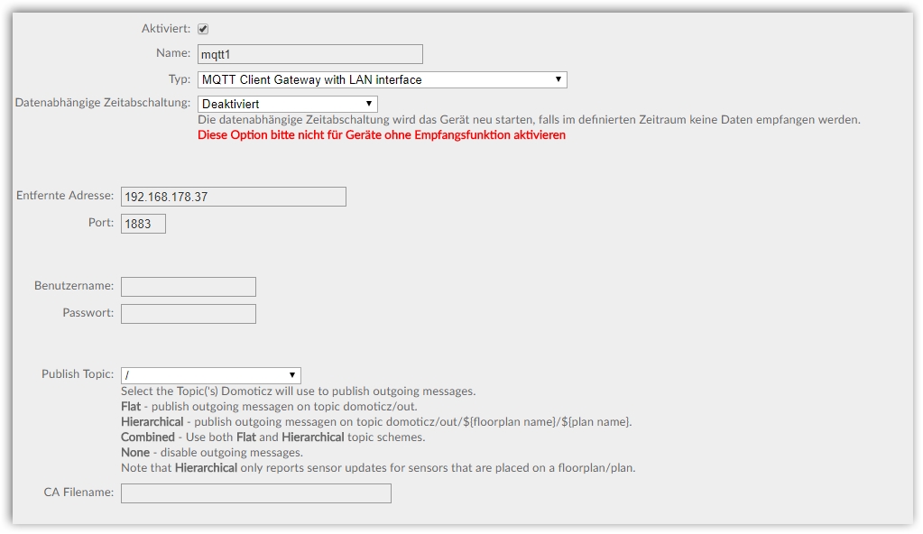

Post by salopette »
Hello, I have looked here https://www.domoticz.com/wiki/MQTT, but I do not understand how I have to adjust in the sketch?
I now create a Virtuall switch, when I enter the command via browser, I see everything.
But how do I go on?
my MQTT is on 192.168.178.37/ port 1883
http://192.168.178.37:8080/json.htm?typ ... es&rid=266

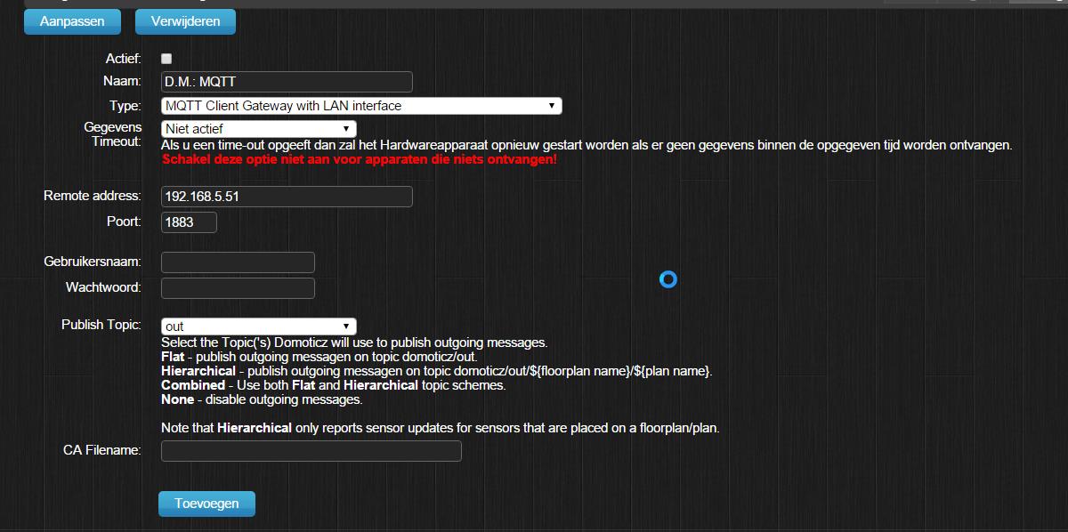

Hello guys,
I am playing with Domoticz now for a few days. My biggest problems with Domoticz and MQTT are the way they are using topics and JSON.
1. Domoticz impose the topics domoticz/in and domoticz/out. Why? It gives you not the freedom affined the MQTT standard. Keep the subscripe and publish topics open ( e.i ALF4all/domoticz and/or ALF4all/domoticz/${floorplan name}/${plan name} ), so you are not overwhelmed with messages if you are using a public MQTT-broker (like HiveMQ).
2. JSON is designed to keep messages readable. An object in Domoticz like "idx":1 (device index) is clear, objects as "nvalue" and "svalue" says nothing. Why not using objects as "temperature" and "humidity"? An object as "svalue":"20.5; 33.3; 2" for a Temp + Humidity type sensor is not readable at all. Better in JSON documents is to split up the data in seperate objects like: {"temperature":"20.5", "humidity":"33.3","humidity-status":"2"}.
Even better: {"temperature":"20.5", "humidity":"33.3","humidity-status":"dry"}.
Perhaps it would be nice if this way is also implemented (not diffecult I think) in Domoticz.
Regards...
Wijnand
b.t.w. As device hardware/firmware I use ESP8266 (thing) -> Arduino IDE -> ArduinoJson.h -> PubSubClient.h -> MQTT -> Domoticz.
