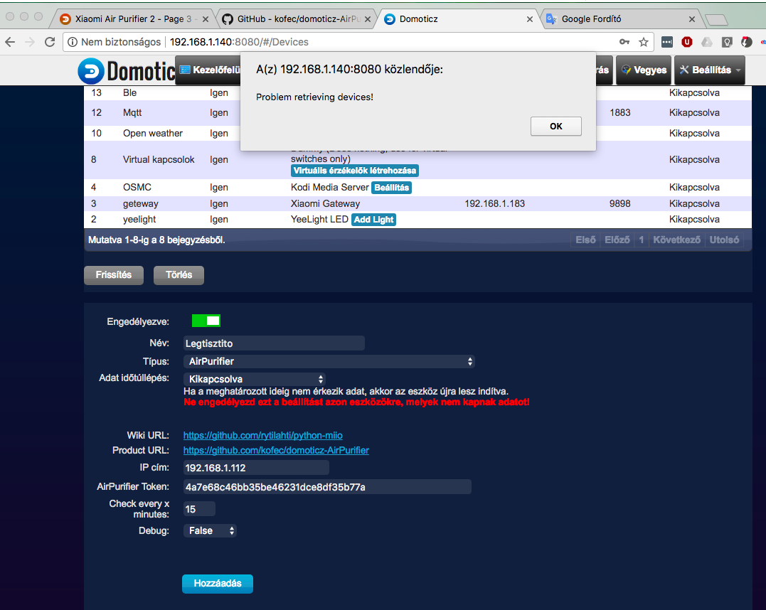

molnaratti
- Posts: 34
- Joined: Friday 02 February 2018 16:21
Re: Xiaomi Air Purifier 2
Works !
./MyAir.py 192.168.1.112 4a7e68c46bb35be46231dce8df35b77a
<AirPurifierStatus power=off, aqi=26,average_aqi=12,temperature=21.1, humidity=44%,mode=OperationMode.Idle,led=True,led_brightness=LedBrightness.Bright,buzzer=True, child_lock=False,favorite_level=10,filter_life_remaining=99, filter_hours_used=1, use_time=5400, purify_volume=54, motor_speed=0>
domoticz crash
domoticz crash
- Képernyőfotó 2018-02-02 - 18.02.52.png (206.62 KiB) Viewed 5728 times
kofec
- Posts: 53
- Joined: Friday 16 September 2016 14:16
Please restart domoticz and copy logs and pastę here

2018-02-02 18:44:56.293 EventSystem: Started
2018-02-02 18:44:57.760 Error: Domoticz received fatal signal 11 !...
2018-02-02 18:44:57.766 Error: /home/pi/domoticz/domoticz() [0x245628]
2018-02-02 18:44:57.766 Error: /home/pi/domoticz/domoticz(_Z14signal_handleri+0x4c) [0x2456e0]
2018-02-02 18:44:57.767 Error: /lib/arm-linux-gnueabihf/libc.so.6(__default_sa_restorer+0) [0xb6c576b0]
2018-02-02 18:45:34.326 TCPServer: shared server started...
2018-02-02 18:45:34.326 RxQueue: queue worker started...
2018-02-02 18:45:36.328 XiaomiGateway: will listen on 9898 for hardware id 3
2018-02-02 18:45:36.329 XiaomiGateway: Delaying worker startup...
2018-02-02 18:45:36.330 YeeLight Worker started...
2018-02-02 18:45:41.330 Kodi: Started
2018-02-02 18:45:41.332 OpenWeatherMap: Started
2018-02-02 18:45:41.332 (Ble) Started.
2018-02-02 18:45:41.333 (purifier) Started.
2018-02-02 18:45:41.334 EventSystem: reset all events...
2018-02-02 18:45:41.338 XiaomiGateway: Worker started...
2018-02-02 18:45:41.340 XiaomiGateway: Using 192.168.1.140 for local IP address.
2018-02-02 18:45:41.343 dzVents: Write file: /home/pi/domoticz/scripts/dzVents/generated_scripts/proba_lépcső_fel_2.lua
2018-02-02 18:45:41.344 dzVents: Write file: /home/pi/domoticz/scripts/dzVents/generated_scripts/nappali.lua
2018-02-02 18:45:41.345 EventSystem: reset all device statuses...
2018-02-02 18:45:41.438 Kodi: (OSMC) Starting thread.
2018-02-02 18:45:41.451 Kodi: (OSMC) Connected to '192.168.1.105:9090'.
2018-02-02 18:45:41.539 Kodi: Starting I/O service thread.
2018-02-02 18:45:41.613 Kodi: (OSMC) Event: 'Video - The Fall [S3E1], Episode 1 (2016)'.
2018-02-02 18:45:41.768 PluginSystem: Entering work loop.
2018-02-02 18:45:42.337 MQTT: Connecting to localhost:1883
2018-02-02 18:45:42.441 MQTT: connected to: localhost:1883
2018-02-02 18:45:42.468 (Ble) Initialized version 0.0.2, author 'mrin'
2018-02-02 18:45:42.482 (Ble) Entering work loop.
2018-02-02 18:45:42.543 MQTT: Subscribed
2018-02-02 18:45:42.914 Python EventSystem: Initalizing event module.
2018-02-02 18:45:42.925 EventSystem: Queue thread started...
2018-02-02 18:45:42.926 EventSystem: Started
2018-02-02 18:45:43.882 Error: Domoticz received fatal signal 11 !...
2018-02-02 18:45:43.888 Error: /home/pi/domoticz/domoticz() [0x245628]
2018-02-02 18:45:43.888 Error: /home/pi/domoticz/domoticz(_Z14signal_handleri+0x4c) [0x2456e0]
2018-02-02 18:45:43.889 Error: /lib/arm-linux-gnueabihf/libc.so.6(__default_sa_restorer+0) [0xb6c2f6b0]Domoticz Version: 3.8875
kofec
- Posts: 53
It looks like generic issue with python plugins. There is a lot about in forum. I'm using latest stable version
