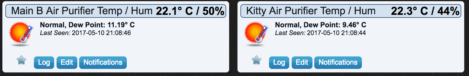

8) For those who want to load the Temperature, Humidity and Aqi (pm2.5 estimate) into Domoticz sensors, below is a updatedomoticz.sh bash script:
#!/bin/bash
while true; do
# Get the data
data=$(node airpurifier.js 192.168.0.240 status)
# Sort it
temperature=$(echo "$data" | grep "temperature" | sed -e s/[^0-9.]//g)
humidity=$(echo "$data" | grep "humidity" | sed -e s/[^0-9.%]//g)
aqi=$(echo "$data" | grep "aqi" | sed -e s/[^0-9.]//g)
# Load it into Domoticz
curl -s "http://USERNAME:[email protected]/json.htm?type=command&param=udevice&idx=607&nvalue=0&svalue=${temperature};${humidity};0"
curl -s "http://USERNAME:[email protected]/json.htm?type=command&param=udevice&idx=599&svalue=${aqi}"
sleep 60
done
Domoticz sensor types to be used are:
Temperature and Humidity: Temp+Hum
Aqi (pm2.5 estimate): custom sensor

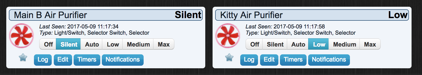

My own Lua device control script for the "Kitty Air Purifier" on my devices tab is:
commnadArray = {}
-- Kitty Air Purifier
if devicechanged['Kitty Air Purifier'] == 'Silent' then
    os.execute ('sudo screen -S airpurifieron -d -m bash /root/xiaomi/airpurifier2/airpurifiercontrol.sh 192.168.0.93 on silent')
if devicechanged['Kitty Air Purifier'] == 'Max' then
    os.execute ('sudo screen -S airpurifieron -d -m bash /root/xiaomi/airpurifier2/airpurifiercontrol.sh 192.168.0.93 on favorite 16')
if devicechanged['Kitty Air Purifier'] == 'Medium' then
    os.execute ('sudo screen -S airpurifieron -d -m bash /root/xiaomi/airpurifier2/airpurifiercontrol.sh 192.168.0.93 on favorite 8')
if devicechanged['Kitty Air Purifier'] == 'Low' then
    os.execute ('sudo screen -S airpurifieron -d -m bash /root/xiaomi/airpurifier2/airpurifiercontrol.sh 192.168.0.93 on favorite 4')
if devicechanged['Kitty Air Purifier'] == 'Auto' then
    os.execute ('sudo screen -S airpurifieron -d -m bash /root/xiaomi/airpurifier2/airpurifiercontrol.sh 192.168.0.93 on auto')
if devicechanged['Kitty Air Purifier'] == 'Off' then
    os.execute ('sudo screen -S airpurifieroff -d -m bash /root/xiaomi/airpurifier2/airpurifiercontrol.sh 192.168.0.93 off')
return commandArray
Screen Shot 2017-05-10 at 9.10.07 pm.png (91.37 KiB) Viewed 21366 times
