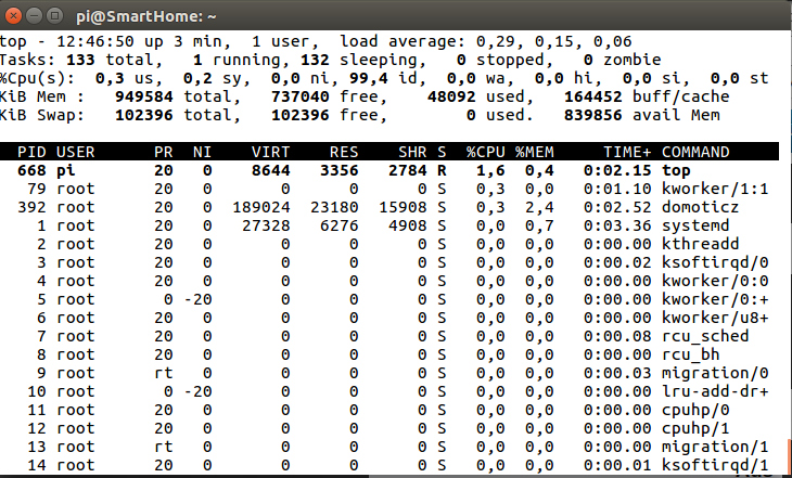

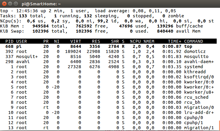

emme wrote: Thursday 01 March 2018 8:24 My understanding the LUA scripting tells me that the os.execute runs the stream and should keep busy the PI raising CPU, but my lack of knowledge in bash and linux system suggest me that the
mplayer -noconsolecontrols should slice the command as a service.. or something like that, so the LUA script should complete with no error and keep it free to be refired...
is that correct?
Hi, yeah thats correct. We have two important options. The first one is the "-noconsolecontrols" to disable the controls. And the second more important option is "&> /dev/null". This second option will close the terminal without any output. The process is running in the background. Here you can see two pictures with and without running radio. The CPU load is very low.
With LUA radio script:
cpu load with radio.jpg (338.26 KiB) Viewed 10700 times
Without LUA radio script:
cpu load without radio.jpg (349.43 KiB) Viewed 10700 times

so I found that if a run Domoticz with init.d some commands on lua script don't work.
but if I start Domoticz with pi user and with ./domoticz command the lua commands work well....
i am so lost right know ...
