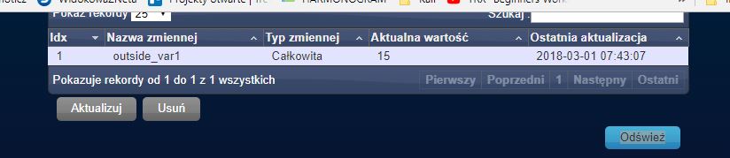

With a simple code like below, I am able to write a value from code to outside variable. Take a look on that masterpiece ;)
print ("All based event fired");
internal_var1 = 5 + 10
print(internal_var1)
commandArray['Variable:outside_var1'] = tostring(internal_var1)
return commandArray
So now I'm wondering how can I display this variable? What kind of indicator should I use?
Then next step is to rewrite a value from a dimmer to this outside variable and then visualize it for example in Percentage indicator.
