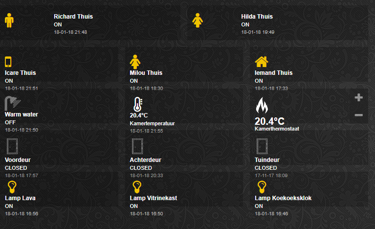

My first post here. I'm a newby as it comes to dashticz. First I want to make big compliments to Rob for making this great application.
Now playing for a week with dashticz, I discovered a lot. Took me three days to get my calendar on the screen. After exporiting, removing and importing my google calendar it finally worked. It appears there was an error in the google calendar.
At this moment there is just one issue I can't figure out: Displaying domoticz switches places the text under the icon and the text is shown outside the box. Widening the box (5 or 6) displays the text next to the icon. My preferred display, but with a lot of space between the icon and the text.
So my question: How to narrow the space between the icon and the text, so that there can be three (or four) boxes in one row. The pictures shows the first column of the screen. Columns width = 5. The boxes on the first row have width 6, the rest of the boxes have the same settings (width =4).
Grtz
Richard
robgeerts
Posts: 1273
Domoticz version: 3.7067
Re: Dashticz - Custom CSS
Post by robgeerts »
Whats your screen width?
By the way, in latest version (beta) it is possible to add something like this in config:
blocks['174'] = {};
blocks['174']['width'] = 4;
blocks['174']['width_smartphone'] = 6;
This means that device 174 (IDX) has a column-width of 4 (like the switches in the second row (and third etc.) in your screenshot) but on smaller screens they will have a column-width of 6.

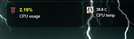

Confused all over the place currently, I hope someone can give this CSS rookie some hints. I'm trying to add the Raspberry CPU (temp, usage etc)
to the dashboard. I have created the hardware device (Motherboard) and have the IDx's 347 and 348 assigned to these 2 devices.
I've added it to the dashboard successfully like this:
CONFIG.js contains:
// RPI Info //
blocks[347] = {}        // CPU %
blocks[347]['width'] = 6;
blocks[347]['title'] = 'CPU usage';
blocks[347]['image'] = 'rpi.png';
blocks[348] = {}        // CPU temp
blocks[348]['width'] = 6;
blocks[348]['title'] = 'CPU temp';
blocks[348]['image'] = 'tuxpi.jpg';
and a partial custom.css for block 347 looks like:
.block_347 .title {
        text-align: center !important;
        vertical-align: middle;
        font-size: 15px !important;
        font-weight: 900 !important;
        color: yellow;
Question number 1:
I would think that the title of this block should contain 'CPU usage', like the CONFIG.js file mentions. However, it seems that this
.title property in the CSS file changes the behavior of the percentage!? The data part (percentage number) has now changed its color to yellow instead
of the 'CPU usage' text, which actually is supposed to be the title of the block...?
Does anyone know if this is expected or did I skip a step somewhere?
Question number 2:
How can I change the size of the image rpi.png in this block? I have tried several things in custom.css like:
.block_347 .image {
        width: 200% !important;
or
.block_347 .image {
        height: 50px !important;
        width: 50px !important;
But image size doesn't change one bit with those settings.
Can anyone provide a hint how I can change an image in a block? Is '.image' not the right property to adjust such image properties inside a block?
Many thanks,
Robert
EDIT: Question number 1 is solved. RTFM...: I just found the required setting for that:
blocks[347]['switch'] = true;
This switches the title and data part of the block.
One down, one to go.

RobertK wrote: Sunday 11 February 2018 20:39
Question number 2:
Try, this probably will work....
.block_347 img.icon,
.block_348 img.icon {
Hardware:
RobertK
Posts: 11
Joined: Wednesday 31 January 2018 22:55
Domoticz version: 3.8153
Post by RobertK »
Thanks! img.icon ... I would not have guessed that.
It works after I also increased max-width for img.icon (otherwise the width of the image did not change, only the heigth changed).
img.icon {
max-width: 50px !important
And now I have to figure out how to shift the title and data parts a bit, such that the image and the text do not overlap :roll: .
Thanks for pointing me in the right direction!

RobertK wrote: Monday 12 February 2018 23:17 Thanks! img.icon ... I would not have guessed that.
img.icon {
Use something like:
.block_347 .title,
.block_348 .title {
	margin-left: 10px !important;
.block_347 .state,
.block_348 .state {
Hardware:

Thanks, but unfortunately that only works for the title. The values (CPU usage and temperature) are apparently not a 'state' value.
Looking at the output with DOM explorer shows:
<div class="col-xs-8 col-icon"...<\div>
    <strong class="title">CPU usage</strong>
    <br />
    <span>2.08%</span>
</div>
Other elements, like on/off switches, do indeed have a state class which I can adjust, but not these ones for some reason...
