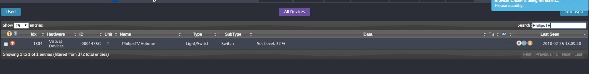

Post by Chakkie »
Hi Madgeni,
I have created a Virtual switch with a dimmer function. However Alexa only recognised as a simple ON and Off switch. I was wondering if it is possible that Alexa can see it as dimmer type lamp.

Chakkie wrote: Sunday 25 February 2018 18:59 Hi Madgeni,
Can you forget that device and do a re-discovery?

Madgeni wrote: Tuesday 27 February 2018 22:00
You are awesome. The switch is now recognized as dimmer. Thank you for your work. Just make a donation :).
