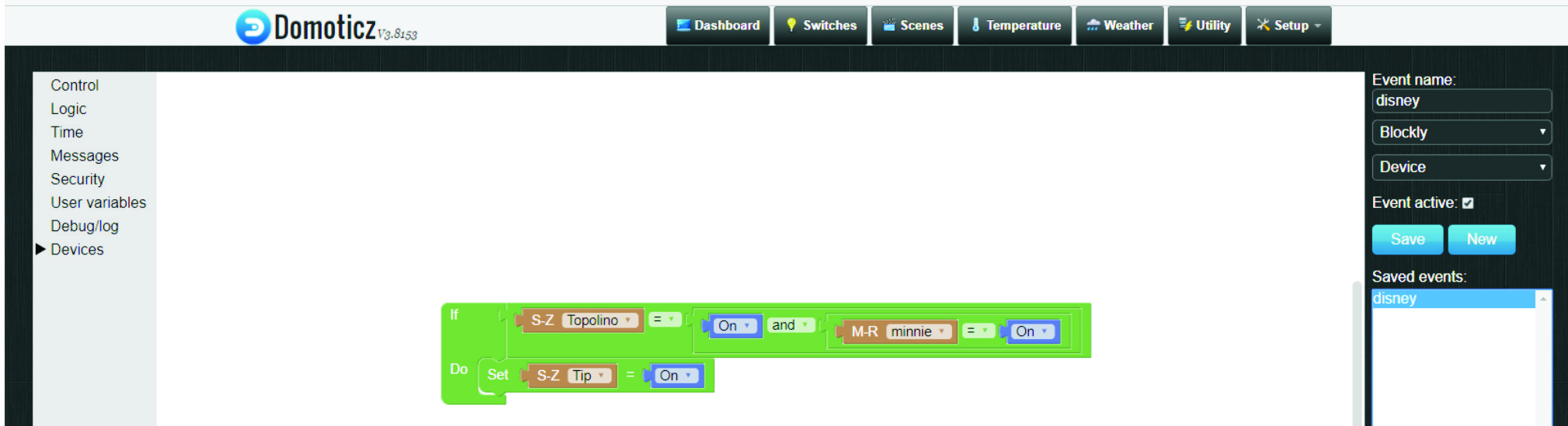

this is the very simple blockly condition:
nothing happens if I put ON topolino and minnie. If I semplify the block with only one condition (only topolino or only minnie), tip change state correctly .

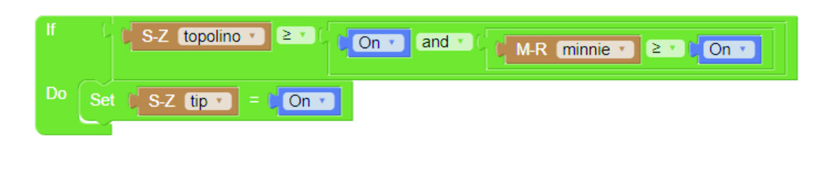

Selected device (ALL).
- domo4.JPG (315.38 KiB) Viewed 1680 times

First pick the "and" block.
Put a condition to the left and one to the right.
Left: topolino=On
Right:minnie=On
Make this:
(topolino=On) AND (minnie=On)
And NOT as yours:
topolino=(On AND (minnie=On)
Left: topolino=On
Right:minnie=On
Make this:
And NOT as yours:

Sorry for my stupidity but... if I put a condition on the left of the AND it's no possible to attach it to the left side...where is my mistake?

Start from fresh.
Your If block is ok.
take an "and" Blockly
Then there is on the left space for a "=" blockly and on the right side for a "=" blockly
Add on the left topolino and On
Add on the right minnie and On
Study the wiki http://www.domoticz.com/wiki/Blockly
and look careful for the surroundings of each blockly part
Example of the AND structure
http://www.domoticz.com/wiki/File:Block ... _group.PNG

OMG! was really easy but I didn't focus on the level of each block! thank you, thank you so much Domosapiens for your precious help!
