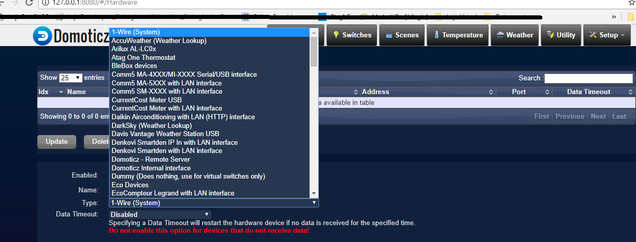

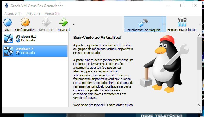

Guys, I do not know what else to do. I was thrilled with the idea of controlling the broadlink and syncing with Xiaomi cameras and gateways, but exhausted all my test possibilities.
I have already tried to install on 2 computers (Notebook / Desktop), with Windows 10 Pro, both to no avail.
The entire installation was in administrator mode.
After all installation, the HARDWARE / BROADLINK option does not appear.
Installed Items:
- Domoticz 3.8892
- Python-3.4.0
- pycrypto-2.6.1.win32-py3.4
- setup ( broadlink )
Note: in Windows 10 several versions of Python have been tested.
Windows 10:
Picture 1
I also created a virtual machine and tried with Windows 8.1 and Windows 7: Note: in Windows 10 several versions of Python were tested.
Picture 2

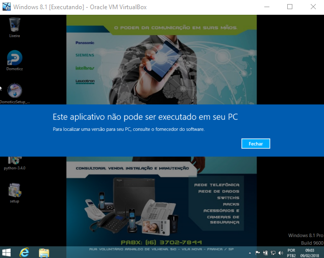

In Windows 8.1 when I went to install "setup.exe" it presents an error:
"This application can not be run on your PC
To locate a version for your PC, consult your software vendor.
Even with the error, I opened Domoticz, and of course, I do not find the broadlink hardware.
Picture 3
In Windows 7, every installation seems to go well.
The "setup.exe" only opens and closes quickly, it does not display any error screen as in Windows 10:
Picture 4
Picture 5
But when I open Domoticz, the broadlink hardware does not appear either ...
Should I give up, I know the forum discussion is already old. Does anyone still use this Domoticz with broadlink?

@leandrosaltori
you need python 3.5.4 x86 installed for all users & include in the path
show me output of this command :
pip --version
pip --version
