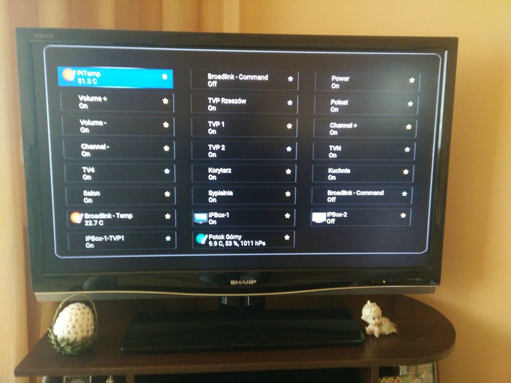

kniazio
- Posts: 203
- Joined: Thursday 06 October 2016 8:14
- Domoticz version: 3.7243
Re: Kodi add-on to control Domoticz
But this plugin does not work for me.
It does not show my devices.
I have yet another plugin.
Very nice looks, shows my devices but they do not switch
https://github.com/h4wkmoon/xbmc-domoticz
Plugin works but only in Scenes.
What to do to work on Switches?
