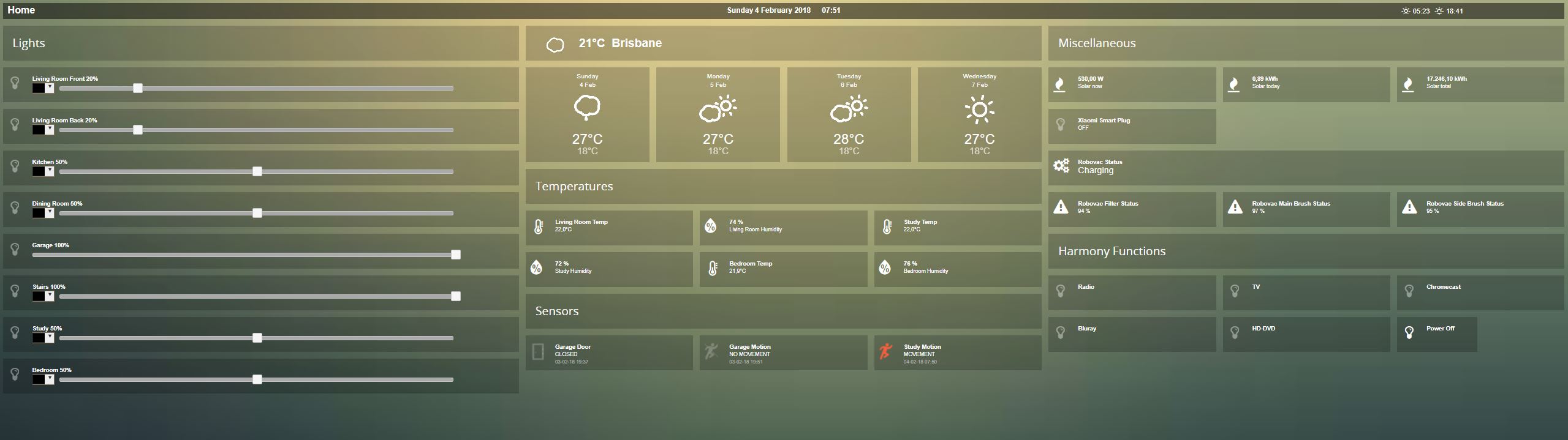

Post by whatisk »
Hoping someone can assist with graphs in Dashticz. They are working for me - I get an error. I did create a separate thread but haven't gotten a response so thought I would try here.
Graphs work fine in standard dashboard, but when I try and add/view one in Dashticz I get a "192.168.1.xxx:10001 says Could not load graph!" where Domoticz ip address and port is listed.
Here is the code of my CONFIG.js

I have attached a pic of the Dashticz dashboard. When I click on OK for the graph error the dashboard loads without displaying it. If I then click on something that can show a graph (eg: temp) I get the same error.
I am running V3.8798 of Domoticz and Beta of Dashticz on a Rapberry Pi 3. The temp sensors are Xiaomi Aqara temp sensors and the Solar inverter is SMA setup via http://www.domoticz.com/wiki/SMASpot_Mo ... n_Domoticz
Would be awesome if someone can assist as I would really like to get graphs working :)

No one has any ideas on my graph issue? It's the only thing missing from my Dashticz dashboard :(
I have tried Chrome, IE and Firefox and all exhibit the same behaviour and updated to latest Domoticz beta and Dashticz beta with no luck, as well as resetting the port Domoticz uses back to 8080. Same error appears whether I use http or https
The error I am getting is: 192.168.1.xxx:8080 says Could not load graph!
Hoping someone might be able to assist/point me in the right direction otherwise I may need to look at backing up the SD Card for the Pi and trying a clean install to see if that makes a difference.

whatisk wrote: Wednesday 07 February 2018 9:40 No one has any ideas on my graph issue? It's the only thing missing from my Dashticz dashboard :(
Found out what the issue was.
If I removed config['standard_graph'] = 'today'; from my CONFIG.js then graphs load without issue.
Correct option is 'day' not 'today'
