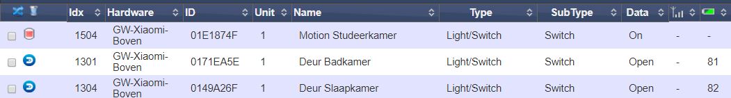

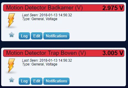

I migrated my Domoticz from old hardware to new.
Everything is working on v3.8875, however the xiaomi voltages are not being updated anymore. The sensors do work just fine.
I enabled the debugging as nicely described in the wiki. It shows.
2018-02-03 11:36:49.783 {"cmd":"read_ack","model":"sensor_wleak.aq1","sid":"158d0001bc18cc","short_id":59728,"data":"{\"voltage\":3045}"}
2018-02-03 11:36:49.784 {"cmd":"read_ack","model":"magnet","sid":"158d0001f34206","short_id":43690,"data":"{\"voltage\":3035,\"status\":\"close\"}"}
2018-02-03 11:36:49.784 {"cmd":"read_ack","model":"motion","sid":"158d0001e1874f","short_id":27271,"data":"{\"voltage\":3005}"}
2018-02-03 11:36:49.784 {"cmd":"read_ack","model":"magnet","sid":"158d0001e5be3a","short_id":11032,"data":"{\"voltage\":3045,\"status\":\"close\"}"}
However...
XiaomiVoltage
XiaomiVoltage
Xiaomi Voltage.JPG (31.63 KiB) Viewed 3481 times
no updates after the migration.
What am I missing here?
I assume it is:
"You can enable separate voltage devices by adding a user variable 'XiaomiVoltage'. This is not really needed as the battery level should be included with each device, but some users prefer to have the 2 separate devices for each sensor."
http://www.domoticz.com/wiki/Xiaomi_Gat ... leshooting
It seems this got mixed with the migration somehow by migrating from old 'stable' domoticz to 'domoticz-beta' on the new machine.
As I do have now:
Voltage2
Voltage2
Xiaomi Voltage2.JPG (35.41 KiB) Viewed 3479 times
