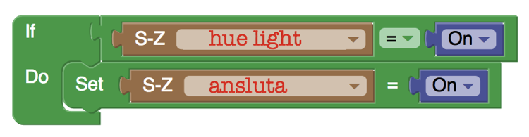

I think you can do this quite simple in Blockly
Schermafbeelding 2018-01-29 om 22.05.02.png (43.49 KiB) Viewed 1890 times

uh yeah, it works.
only problem: if hue liht is "hard set off" (disconnected from power with a regular switch) its status seems to be different from "off", so this ist not recognized. What to set then?

rechsoz wrote: Monday 29 January 2018 23:05 uh yeah, it works.
Does Domoticz recognize the Hue Light as OFF when its disconnected from power with a regular switch?
