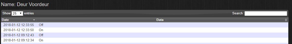

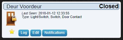

This strange thing happens sometimes:
I open the Door but pass2php reports door closed.
I close the door.. and pass2php reports door open..
2018-01-12 12:33:50.666 telegram sent to Phone: Voordeur is Geopend
2018-01-12 12:33:52.114 Voordeur: Closed
2018-01-12 12:33:55.371 De voordeur is weer gesloten
2018-01-12 12:34:52.143 Voordeur: Open
2018-01-12 12:35:52.595 Voordeur: Open
The cache reports door open however it is still Closed.
Door Closed.JPG (19.15 KiB) Viewed 3050 times
Voordeur log.JPG (34.16 KiB) Viewed 3050 times
Any ideas??
I have to force a cache refresh ;-) and it is in sync again.

Egregius wrote: Friday 12 January 2018 23:26 Must be that domoticz is sending those values, no?
I've never seen that on any of my 7 door sensors.
I still have the issue with only 1 door 'Deur Voordeur'. After cache refresh it is okay.
After opening and closing the door we again have an issue.

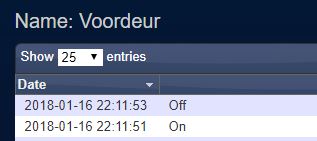

Well this does happen now:
2018-01-16 22:11:51.685 telegram sent to GSM: Voordeur is Geopend
2018-01-16 22:11:53.540 Voordeur = Closed
2018-01-16 22:13:07.704 Voordeur = Open
Domoticz shows:
I changed t he name of the sensor back from "Voordeur" to "Deur Voordeur" and opened and closed it 3 times.
