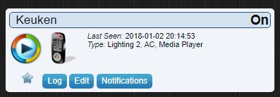

For some reason pass2php forgets the status of a device, and it does not update it automatically:
Kodi Keuken.JPG (19.03 KiB) Viewed 2694 times
It is a kodi mediaplayer that is always on. There is a keuken.php file as when it is in sync it does work.
I created a debug line in _cron60.php that gives me:
Amp value is: 0.0 status of Keuken kodi is: status of TV Keuken is: Off Woonkamer is: Video
There is a logrotate script at around 00:05 hours, sometimes this initiates a restart of domoticz. (monit says pid changed for process domoticz)
Could this be a cause resulting in variables being reset or filled with nothing?
I modified the daemon args to secure the log in case of a monit restart as your monitor script already takes care of it. Maybe... 2 monitoring services is not the best idea :lol:
DAEMON_ARGS="$DAEMON_ARGS -log /var/log/domoticz-$NOW.txt"

The cache is only updated when domoticz triggers the device lua script. Must be that domoticz is sending a empty value upon restart.
But, if it's always on, why have it in domoticz tjen?

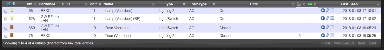

For some reason it changes the state of the door Voordeur back to open... but i did not touch the door.
And domoticz shows the door is closed.
KI think this issue was due to the following
Device: Deur (Voordeur) is connected RFXCOM (on ground floor)
Device: Deur Voordeur is connected to RFLINK (on 1st floor)
In the old situation I would link both devices to each other in domoticz. (sub/slave device).
So the (Voordeur) closes... and rf-link does not notify this.. Domoticz will switch the status of the sub/slave device. However this will not trigger an action hence pass2php does not know the status changed of this device.
I now unlinked both devices and have pass2php only look at (Voordeur). That seems to have solved the issue
2018-01-03 20:21:14.876 --->> Deur voordeur: Open Deur (Voordeur): Closed
