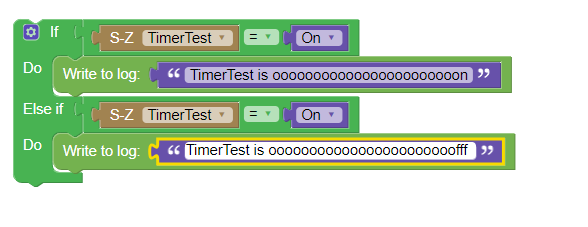

I have a blockly event that doesnt seem to work.
It is based on the event type time and should fire every minute.

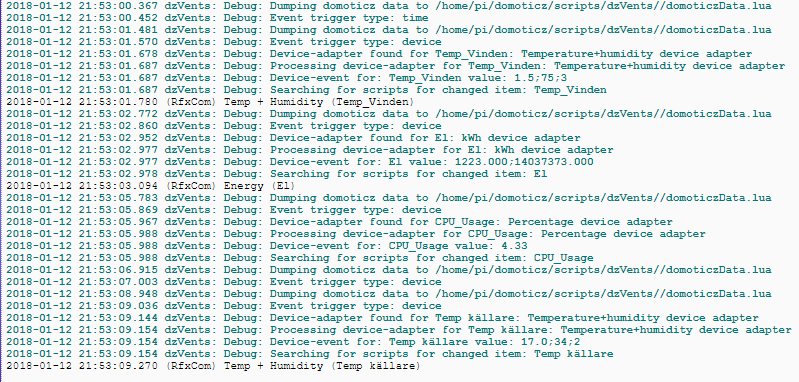

I can see in the extended log file that Domoticz is running timed events every minute on the minute,
but nothing happens
Any ideas?

You are testing for On in both tests. What is the value of TimerTest?

Sorry it should bee off.
I have tried both on and off but no message in the log
This was another try at it, same result, nothing

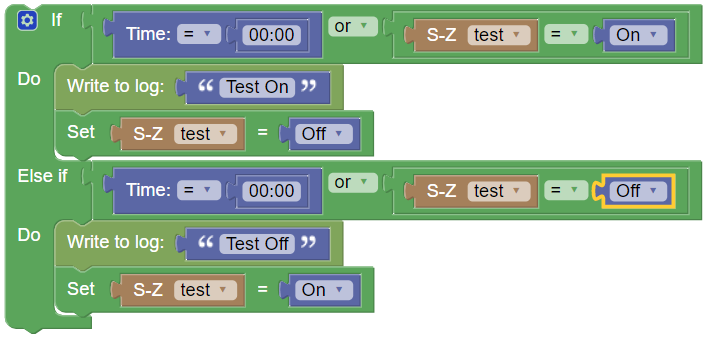

Either way, something in my mind told me that blockly needed a time test in there for it to work and this indeed does work:
It didn't without the OR Time test. I am not a blockly buff so maybe somebody can comment in case it should have worked.
