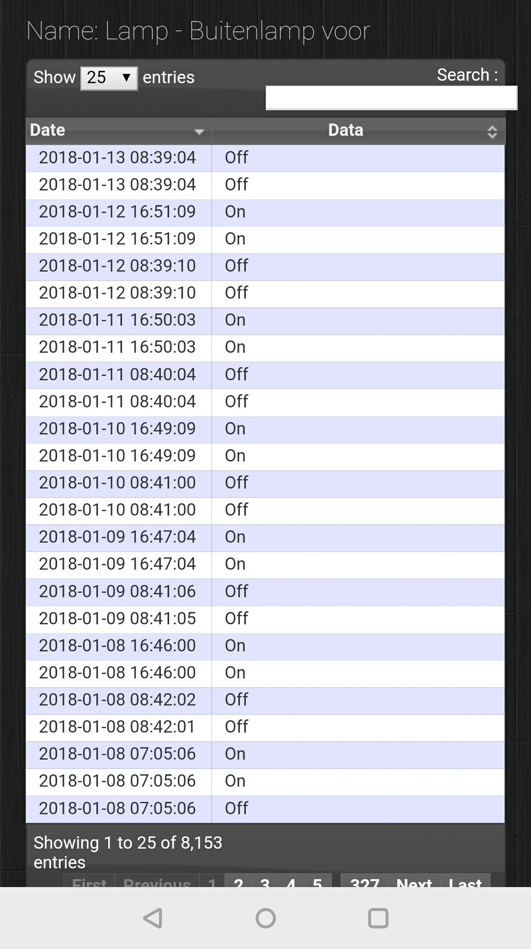

Did you look in the log of the switches to see if they are put on or off ?
Also nothing wrong in the devices page ?

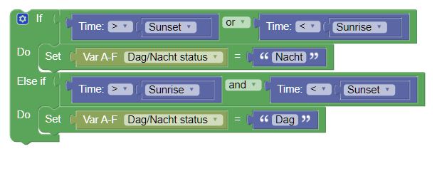

I am using a variable which calls it DAY or NIGHT.
By using this variable in a event that turns the lights on or off, it works...
At the event where i switch the light on/off, you see i also want to know if its on or off..
When you dont do this, your log will keep showing: On, On, On, On, On, On, On, On, etc ;)

Looks good, but it should work anyway with the timer function.

I tried the two events and at first nothing happened. The lamp was off and stayed off.
I had to put the switch manually on and off and then the lamp went on and cannot be put off manually (and that is correct).
Is it normal to start an event this way?

Hi Sandy,
Did you test the events yourself?
This morning i noticed that the lamp was still on.
In the log of the switch there is no off action.
So it is not the NeoCoolcam.
Manual switching works perfect.

Yes, i have this running for a couple of weeks now..

Blockly events are running correct.
