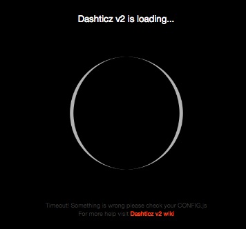

Post by gjaa »
cdegroote wrote: Saturday 06 January 2018 19:55 Remove / and * at beginning and end of CONFIG.js and everything works normal
I get the latest version (Beta)
cp CONFIG_DEFAULT.js CONFIG.js
edit my IP
Saved
Start Dashticz and I can save but it does not change the CONFIG.js
When I remove the suggested lines I've got an error
So thats not the solution
