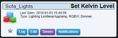

Nope. 'Set to white' has no effect. Oh.. Other than showing 'Set Kelvin Level' on the switch in the Domoticz dashboard.Madgeni wrote: Wednesday 03 January 2018 20:06 so, if you ask google to set a light to white, does it work? Not 'warm/cold' white - which would probably go via Kelvin, but simple colour switch.
I'd had a look at that kelvin level thing, but it seems - suboptimal..
