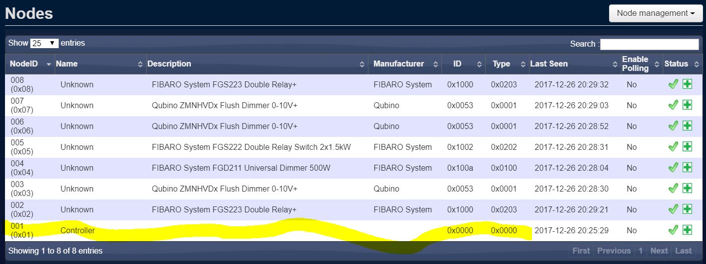

I know that 0x0000 normally happens when the hardware is not known to Domoticz (right?).
But I have a standard Aeon Z-Stick gen5 that shows this!! The nodes I'we included sp far seems to show up as they should.
Any ideas anyone?
Running win10 and 3.8796.

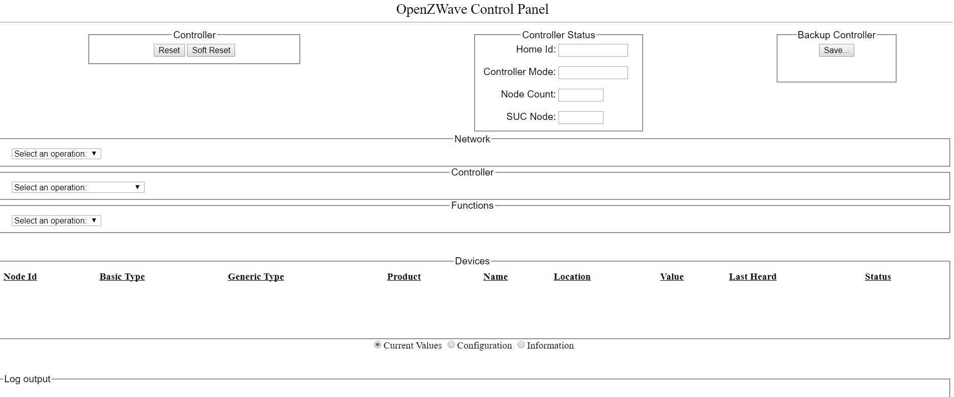

Might add that the OZW control panel i blank...
I can however turn one of the node on and off...

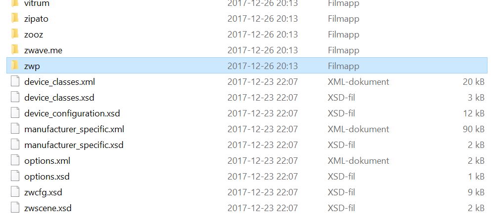

Next strange thing.. no config file is created?
/lennart
