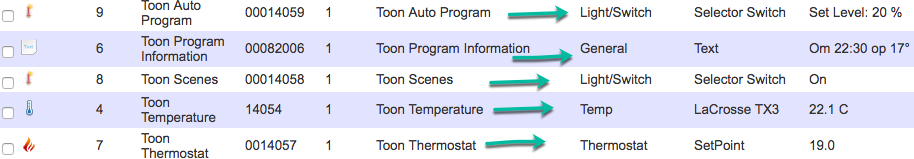

Hello All,
Thanks for explain how I can connect my Toon in Domoticz this works great :-)
Now I want to add Toon in Siri, I can switch my lights on in Siri with Domoticz, but Toon I don't get in :-(
I see Toon Auto Program as light switch and Toon Scenes as Light switch, I cannot use this in apple home kit so properly I do something wrong.
I also can not see the temperature etc.
This is how I set it up:
My toon set up in domoticz

PHP is now working on my raspberry pi and I install the gas_data_json.php and analog_electricity_data_json.php meters.
I changed the IP adress plus IDX.
I had needed also to 3.1 to dev 2.1 and 2.2 because when I open the website of the toon there was no dev 3.1 and I had an error in this scrip.
the only two problem for now is this:
for the gas_data_json.php:
./gas_data_json.php
PHP Notice: Undefined index: result in /home/pi/domoticz/scripts/p1_meter/gas_data_json.php on line 36
Gas Value Domoticz = 0 liters
Gas Value Toon = 7360.00 liters
"status" : "ERR"
and for the analog_electricity_data_json.php:
./analog_electricity_data_json.php
PHP Notice: Undefined index: result in /home/pi/domoticz/scripts/p1_meter/analog_electricity_data_json.php on line 42
Electricity Counter Domoticz = 0 Wh
Electricity Counter Toon = 123970.00 Wh
Electricity Usage Toon = 743 Watt
"status" : "ERR"
I don't know where this error is comming from so hopefully somebody could help me.
michel30
Posts: 19
Joined: Tuesday 12 December 2017 21:00
Re: Controlling Toon [HACKED] from Domoticz
Post by michel30 »
Finaly I found my issue.
IDX was on hardware not on device now it is working for me also with analog meter.
