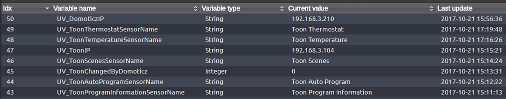

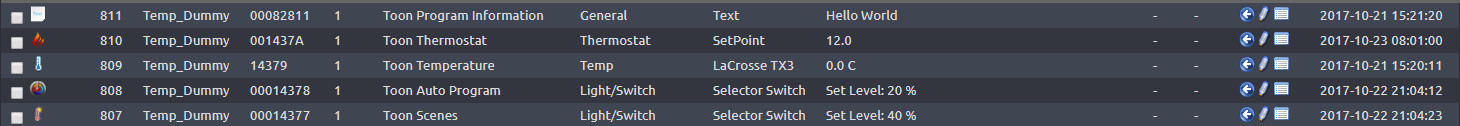

I try to make the hacked Toon work with Domoticx work but I get an error and don't know what's wrong
The error is this:
2017-10-22 20:33:00.621 Error: dzVents: Error: An error occured when calling event handler ToonGetInfo
2017-10-22 20:33:00.621 Error: dzVents: Error: ...cz/var/scripts/dzVents/generated_scripts/ToonGetInfo.lua:61: attempt to call field 'round' (a nil value)
Line 61 is this one out of the script:
if domoticz.round(domoticz.devices(ToonTemperatureSensorName).temperature, 1) ~= domoticz.round(currentTemperature, 1) then
The following :
local ToonThermostatSensorName = domoticz.variables('UV_ToonThermostatSensorName').value -- Sensor showing current setpoint:
the user variable UV_ToonTemperatureSensorName is filled in as Toon Temperature and Toon Temperature exist as a virtual Temp(erature) variable.
I hope someone can point me out what is wrong
Best regards Bert

Can you post a screenshot of your "Devices" and "User variables" ?

My variables:
My devices:

        --local handle = assert(io.popen(string.format('curl http://%s/happ_thermstat?action=getThermostatInfo', ToonIP)))
        local handle = assert(io.popen(string.format('curl http://192.168.3.104/happ_thermstat?action=getThermostatInfo', ToonIP)))
        local ThermostatInfo = handle:read('*all')
        handle:close()
        local jsonThermostatInfo = json:decode(ThermostatInfo)
        if jsonThermostatInfo == nil then
            return
        local currentSetpoint = tonumber(jsonThermostatInfo.currentSetpoint) / 100
        local currentTemperature = tonumber(jsonThermostatInfo.currentTemp) / 100
        local currentProgramState = tonumber(jsonThermostatInfo.programState)
            if currentProgramState == 0 then currentProgramState = 10 -- No
                elseif currentProgramState == 1 then currentProgramState = 20 -- Yes
                elseif currentProgramState == 2 then currentProgramState = 30 -- Temporary
        local currentActiveState = tonumber(jsonThermostatInfo.activeState)
            if currentActiveState == -1 then currentActiveState = 50 -- Manual
                elseif currentActiveState == 0 then currentActiveState = 40 -- Comfort
                elseif currentActiveState == 1 then currentActiveState = 30 -- Home
                elseif currentActiveState == 2 then currentActiveState = 20 -- Sleep
                elseif currentActiveState == 3 then currentActiveState = 10 -- Away
        local currentNextTime = jsonThermostatInfo.nextTime
        local currentNextSetPoint = tonumber(jsonThermostatInfo.nextSetpoint) / 100
        local currentBoiletSetPoint = jsonThermostatInfo.currentInternalBoilerSetpoint
        -- Update the thermostat sensor to current setpoint
        if domoticz.devices(ToonThermostatSensorName).setPoint*100 ~= currentSetpoint*100 then
            domoticz.log('Updating thermostat sensor to new set point: ' ..currentSetpoint)
            domoticz.devices(ToonThermostatSensorName).updateSetPoint(currentSetpoint).silent()
        -- Update the toon scene selector sensor to current program state
        if domoticz.devices(ToonScenesSensorName).level ~= currentActiveState then  -- Update toon selector if it has changed
            domoticz.log('Updating Toon Scenes selector to: '..currentActiveState)
            domoticz.devices(ToonScenesSensorName).switchSelector(currentActiveState).silent()
        -- Updates the toon auto program switch
        if domoticz.devices(ToonAutoProgramSensorName).level ~= currentProgramState then -- Update toon auto program selector if it has changed
            domoticz.log('Updating Toon Auto Program selector to: '..currentProgramState)
            domoticz.devices(ToonAutoProgramSensorName).switchSelector(currentProgramState).silent()
        -- Updates the toon program information text box
        if currentNextTime == 0 or currentNextSetPoint == 0 then
            ToonProgramInformationSensorValue = 'Op ' ..currentSetpoint.. '°'
            ToonProgramInformationSensorValue = 'Om ' ..os.date('%H:%M', currentNextTime).. ' op ' ..currentNextSetPoint.. '°'
        if domoticz.devices(ToonProgramInformationSensorName).text ~= ToonProgramInformationSensorValue then
            domoticz.log('Updating Toon Program Information to: '..ToonProgramInformationSensorValue)
            domoticz.devices(ToonProgramInformationSensorName).updateText(ToonProgramInformationSensorValue)
        print("currentTemperature - " .. currentTemperature)
        -- Update the temperature sensor to current room temperature
            domoticz.log('Updating the temperature sensor to new value: ' ..currentTemperature)
            domoticz.devices(ToonTemperatureSensorName).updateTemperature(currentTemperature)
Best regards Bert
