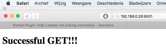

Had a better look. Started domoticz on commandline and browsed from Mac on 192.168.0.81 to the Domoticz URL defined in the plugin (192.168.0.28:8008)
In the Domicz output I see that the GET from the browser is received:
- onConnect handler is called
- onMessage handler is called
=== "succesfull get" page is sent
=== and "succesfull get" page is received again, huh!?
But the "succesfull get" page is not shown in the browser.
Could it be that the page is returned to the IP of the Domticz server instead of the Ip of the requesting browser?

Just tested yor BTLEscan plugin, and I can connect to the server part:
Schermafbeelding 2017-12-21 om 13.27.41.png (35.47 KiB) Viewed 2388 times
At least I know now that the problem is not in my setup, but in the HTTP Listener example.
