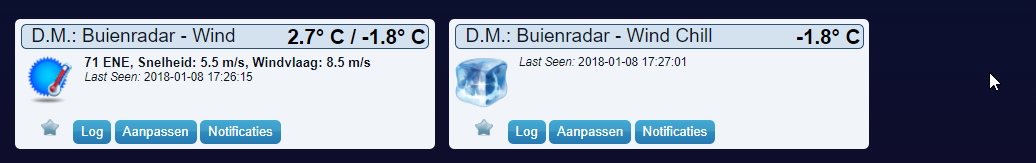

Is there perhaps a option to use the wind chill separate as 1 device?
I think this a extra option in the winter...
The data is in the list:
Or can you make this in your plugin like the text funtion etc etc
Thanks from my kids... when they get a mail how cold it feels when they have to go school..
2018-01-07 23:10:58.332 (D.M.: Buienradar) Wind Speed: 5.19 | Wind Bearing: 60.0 | Wind Direction: ENE | Wind Speed Gusts: 10.0 | Wind Chill: -6.4Code: Select all
2018-01-07 23:10:58.333 (D.M.: Buienradar) Weather prediction today: Wind maakt het extra koud (Opgesteld op zondag 7 jan 2018 om 10:15)
Re: Buienradar Weather Lookup Plugin
If you want, you can do it manually by adding device 13 in the file plugin.py. It works for me.
Put it in the place where I put it. It the code with unit 13.
You can see by the code where.
Yes there will be a new device in the Temperature tab with 'Buienrader Wind Chill'

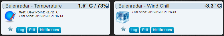

Not completely the same:
In the Temperature tab 2 Temperature device like below.
